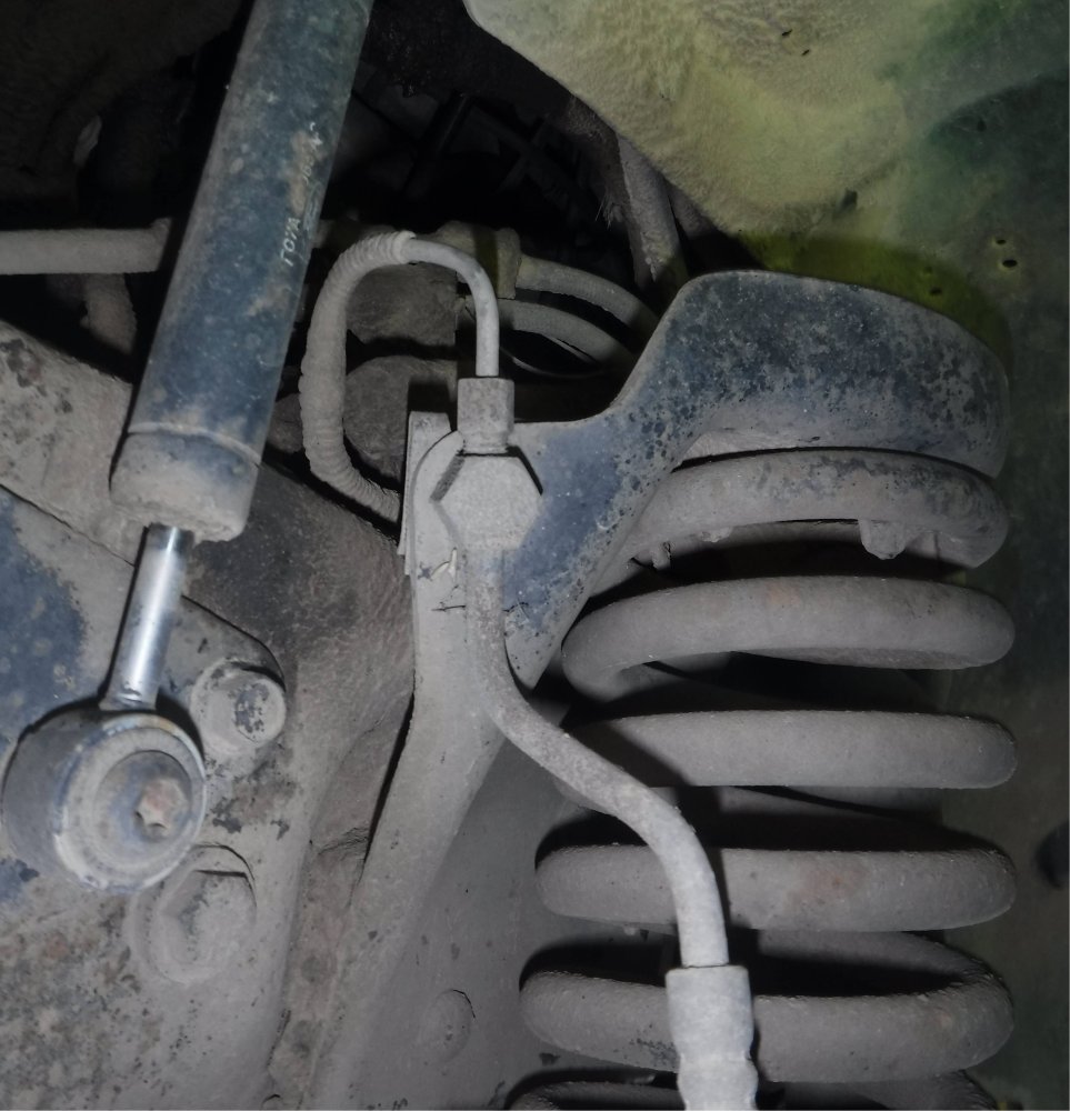

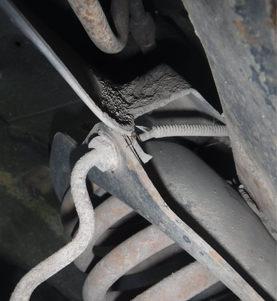

here's a look at mine if it helps, been about 3 years since I put new ones in
passenger side
driver side
