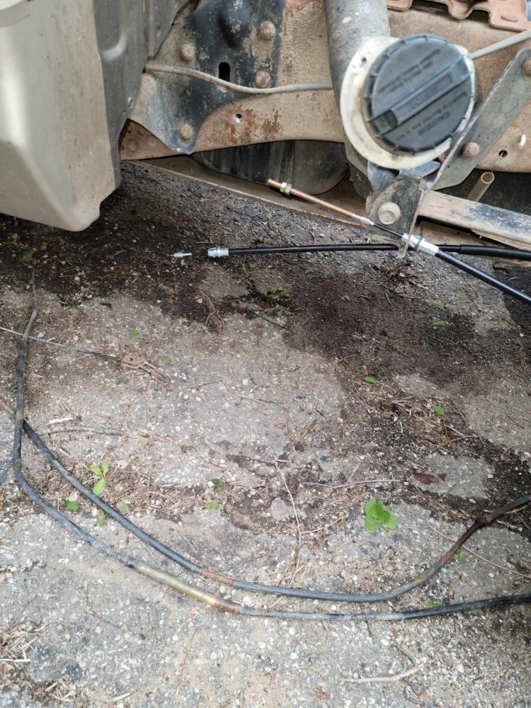

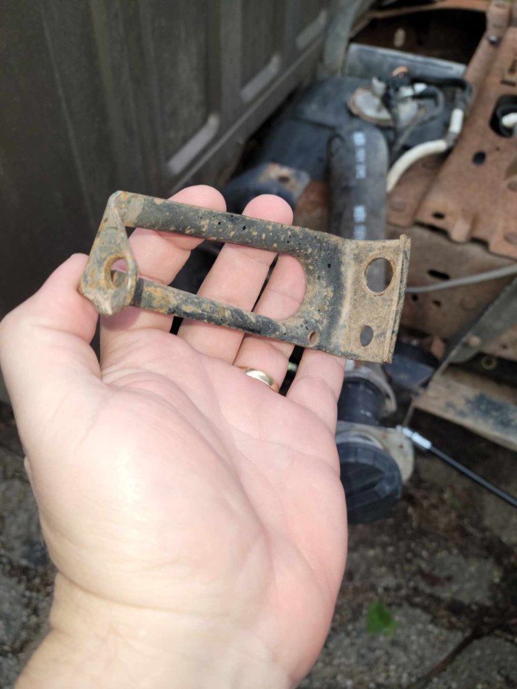

I have a 1990 Ford Ranger with the extended cab and when It the rear axle was trash so I thought I found a replacement and took it all apart to take as a core for the new one then drove 3 hours and it was the wrong one long story short a year later I found the right axle and got it but it was missing everything I replaced the brakes their 9in drums and got 2 new parking cables hook them up in the drums and ran them up to under the frame where the old ones were about even with the fuel filler cap on the body but for the life of me I can't remember how they went back together it have a weird bracket that has 2 holes on 1 side and 1 on the other one of the new cables has a threaded end I know that the front cable from the cab and the 2 from the rear have to hook up with this bracket but I can't figure it out or where the bracket mounts I found a diagram on another thread with a small illustration if you have an XLT or Super Cab or something but it doesn't give me the picture of real life where does everything go and I have spent hours trying to find a picture on the internet of the connection but it's like it doesn't exist only thing I can find is 94 and up but it looks nothing like what I have I also went to 3 different junk yards trying to find an old ranger to crawl under and find my information but the owners of the yards said they don't have very many older cars cause the Biden administration gives them extra money to scrap old cars maybe that's why it took me a year to find and axle 3.73 gears with a 7.5" ring gear with 10" brakes had to drive 3 states away and pay 500 bucks for one but it only had 9" brakes, that's what I get for buying a fixer upper but I can't let the wife be right that it will never move so if any one here can help me with a picture of how these 3 parking cables come together and where they mount I would love you forever.

I have an 88 extended cab and I know what you are talking about with the weird bracket under there. Mine is not right. Next time I get to the salvage yard, I want to see how it is to go as mine is messed up as well. Hopefully someone will post a picture of theirs on your post as I need the same picture as well.
I know the bracket and 3 cables come together and mount somewhere lol

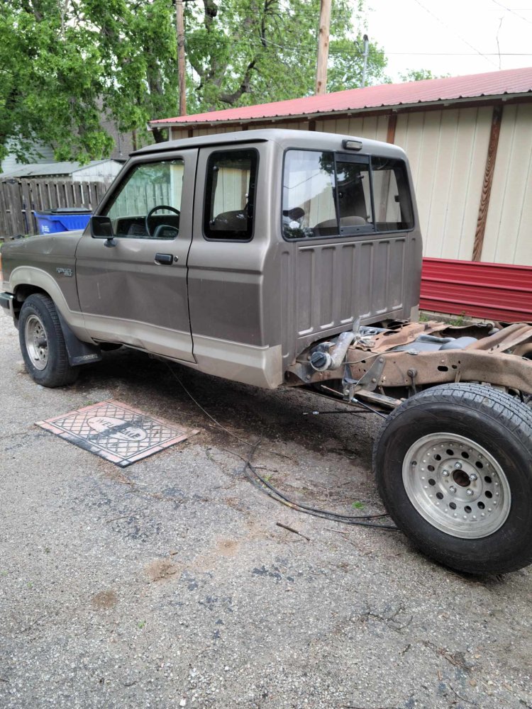

Some more pictures don't mind the mat the wife put it there because she said it would never move lol

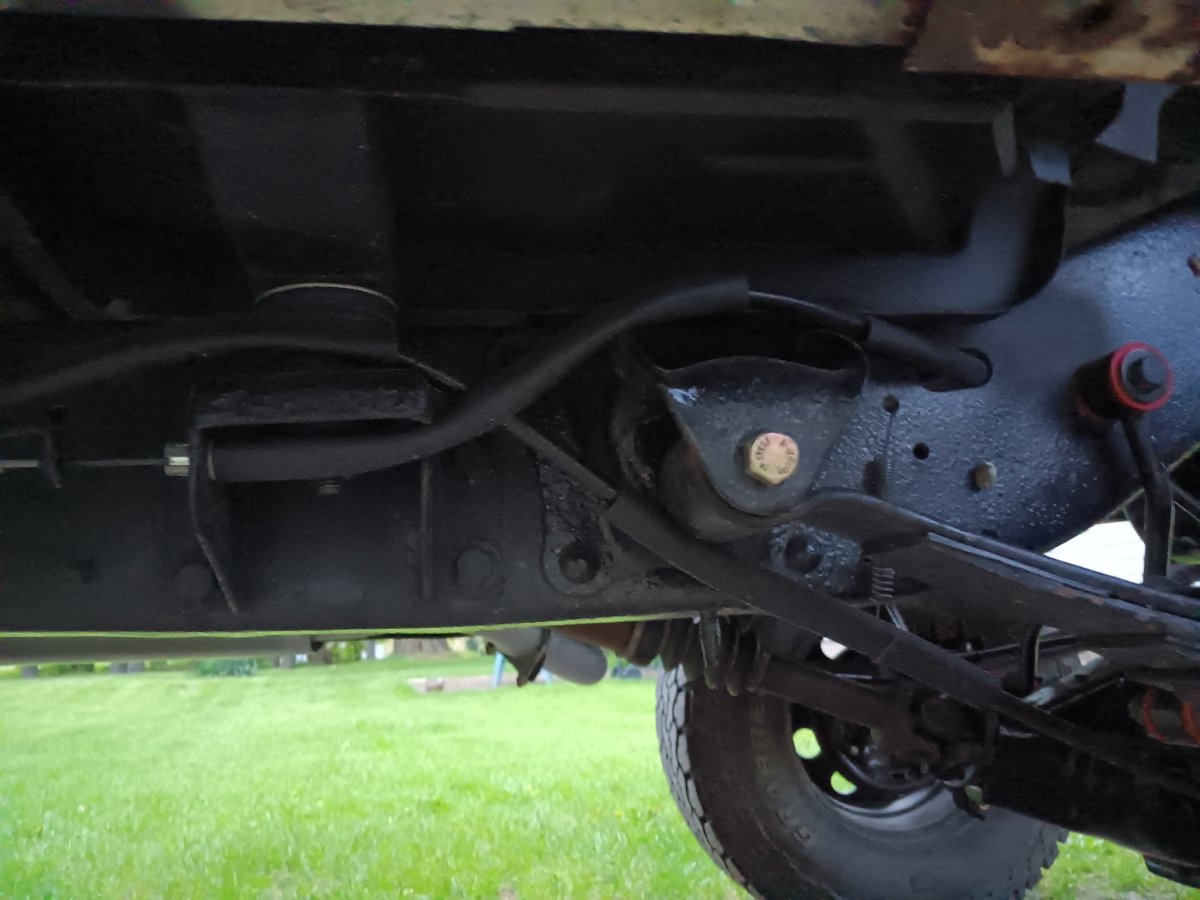

Dam I had that soooo wrong I was trying to bolt the bracket to the frame Thank You so much
Do you have one a little farther back so I can see where to run the cables?
My rig is a BII and it has a 6" lift so I had to be creative running the cables. I'm not sure if they are in the factory position.
Looks better then my zip tie idea many thanks
