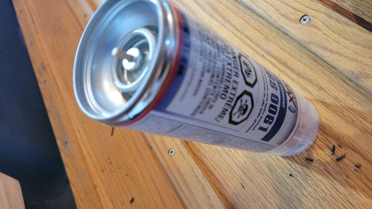

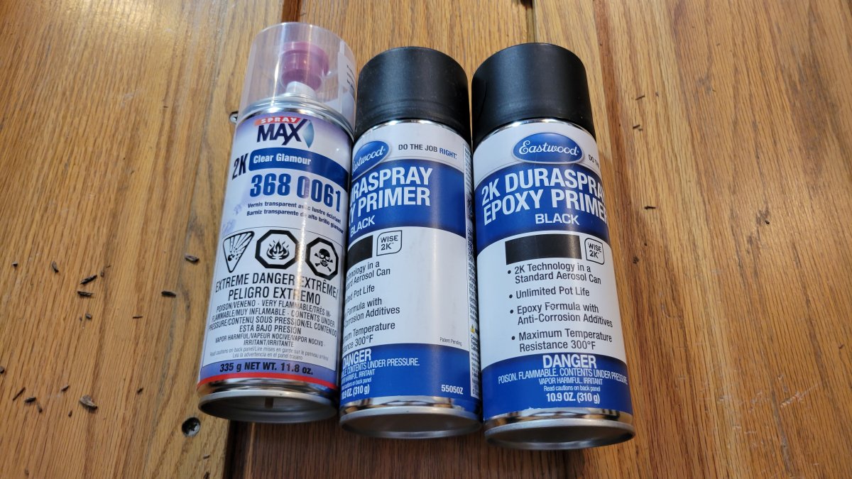

These days, the best stuff is 2K "epoxy." 2K seems to lay down very good. The primer is just a regular rattle can, but the paint and the clear coat is a two part time sensitive product which releases a catalyst. Basically it's the same stuff that comes on factory finished cars and golf carts too.
These are true 2 part paints and clear coats which come with a red button on the cap. that button is placed on the bottom of the can and depressed in order to release the catalyst.
The photo shows the primer and the clear coat. I did not have any base coat handy.
The next photo shows the bottom of the clear coat can. It will release a catalyst when the red button is attached. This is a time sensitive product. It does not air dry. Both Eastwood and NAPA sell true 2K paints. I dunno. Maybe there are others. This is good stuff. It will last a very long time. You will still need to fine sand, but less.
