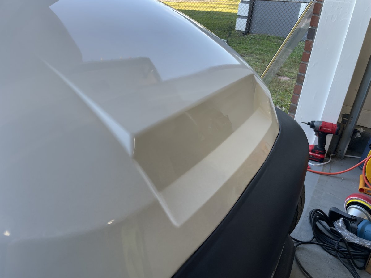

An update. I finally got to it. These body panels are incredibly thin. The front is probably thinner that the rear cause it has a framework supporting the entire thing. It feels like those cheap, disposable paint cups and the hardware store, though that has allot to do with their size. I decided to buff them out since they're solid white all the way through.
I've never buffed before, and the foam buffing pads don't remove large blemishes. I ended up doing a good bit of sanding with 400 grit (cause that's what was in the drawer). There used to be a large sticker on the hood that is almost unnoticeable now. The pin stripe decal protected the plastic and is still fairly obvious that it was there. I removed a good bit of material till I figured it was good. I think this is the way to go. These pics don't do it justice. It's not a mirror finish, but is much nicer. Look at the clarity of the flood light under the eve.
The rust stains on the rear panel will probably be really deep in the plastic. I have low hope that those will come out without some serious sanding... to the point of making a weak spot. I'll give it a go tho.
I used the top-of-the-line DA polisher from HF.

I meant that I sanded and then buffed. Just buffing didn't take off enough material to get rid of the blemishes left behind by years of sun damage (when contrasted by the portion protected by the pin stripe decal).
Really what happened is I buffed and buffed and pondered, then sanded, then buffed, then really sanded hard, then buffed again, and a couple more times just to see what happens. I was really just playing with the buffer since I'd never used it before. Tried heavy cut compound, final polish compound, foam pad, microfiber pad, and plastic specific polish.
My ultimate takeaway was that a buffer (and any product related to buffing) takes so little material off the surface that it's surprising... which really makes sense since it's meant to just treat the surface of one layer of paint (or clear coat). My goal was to shave the surface off of this body panel... like... measurable with vernier calipers. This was a good thing to experiment on since there are no coatings on it. It's just white plastic that's been polished to be shiny.
