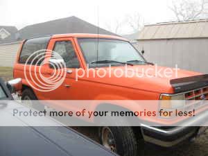

I painted my 90 Bronco II at least 3 years ago using the TSC tractor paint. It was Kubota orange and I used the hardener that was on the rack near the paint. I have since sold it, but I still see it on craigslist about once a month. It is a little lighter than it was then, but it still don't look bad if you like the color. I wish I would have repainting the handles black and reattached the emblems before it left.
http://limaohio.craigslist.org/cto/2067325120.html
Here are the pics from the craigslist ad I just found of it.
Looks like they might have been in a slight crash with it too since then by looking at the bumper.
I found a picture of it when I still owned it. This was shortly after paint. My ranger is parked to the left of it.
I know I had less than $100 in this paint job. The paint at the time was ~ $25 and I think the hardener was less than $10. The rest was just sand paper. I would recommend not using the primer they have there. It takes too long to dry so you can sand it. I ended up using some left over primer from when I painted my ranger.
