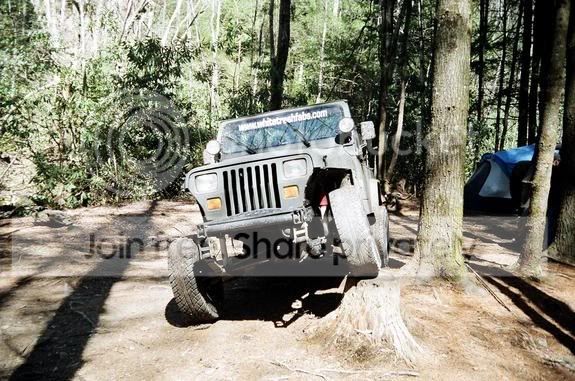

i say fawk rattle can, u cant ever get it thick enough for good coverage, and durability, and yea ive rattle a few of my ride. heres my jeep
