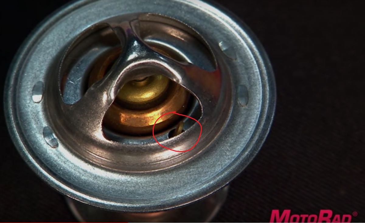

@Dirtman, the new t-stat does apparently have a jiggle valve, it's a Motorad 2000195 for anyone looking at this for reference. It isn't located on the flange like the old one though, it's under the frame closer to the piston.
That would defeat the purpose of a "jiggle valve", it needs to be on the flange, closer to the edge the better, and then when installed its put at the 12:00 position
Jiggle valve is there to let AIR out from behind thermostat when its closed
When you refill the system take one heater hose off at the firewall, that will let air out when there is no jiggle valve
I guess I'm a bit confused as to which part is the jiggle valve. Is this actually the bypass valve?
56016
That's a jiggle valve
But for a thermostat that would sit facing down, like in a 4.0l SOHC, not good for sideways mounting
The distance from the jiggle valve(mounted at 12:00) to the top of intakes water passage is the amount of air that can be trapped behind the thermostat when its closed
So you could have 1.5"-2" of air trapped behind thermostat
The above jiggle valve wouldn't be any better that waiting for the thermostat to open, lol, BUT........it would let out enough air to at least keep thermostat covered with warm coolant so it COULD open and let more air out
Just giving you a hard time :)
But jiggle valves do belong at the edge of thermostat plate when its mounted sideways, or anytime really, not sure of the thinking of MotoRad on that one

Would it hurt anything to drill an itty-bitty hole on the flange that would sit at 12 o'clock? Say less than 1/16" or so. Should serve the same purpose, right?
Yes, that's fine, I do an 1/8th inch hole when I get one that doesn't have the jiggle valve
