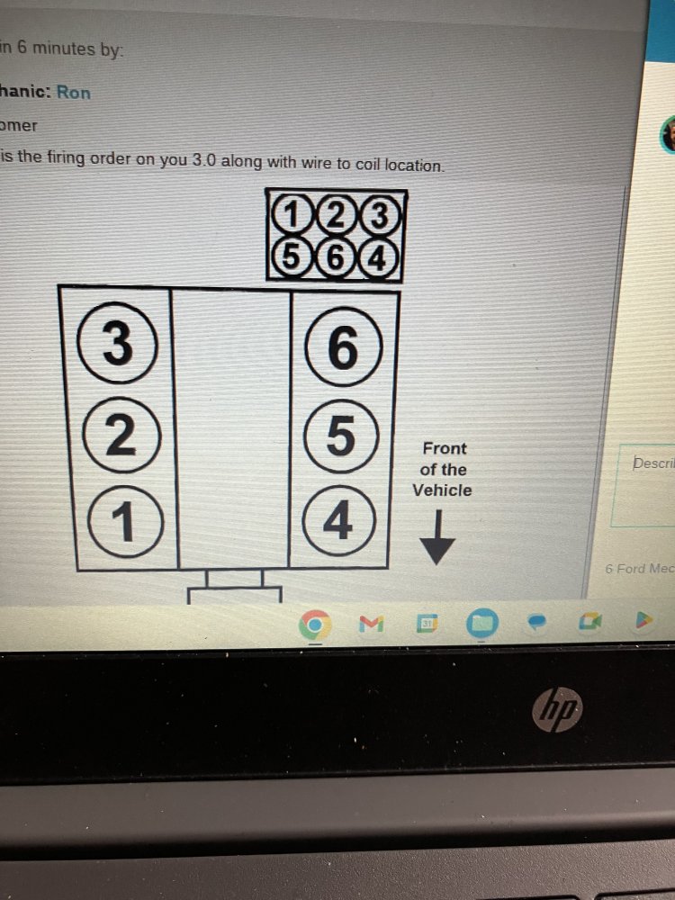

i know the plugs go 1-6 passenger side to drivers side from the front.what is the order on the coil pack passenger to driver side .1998 3.0 ranger.thank tim
Coil packs are done in Matched Pairs
On a V6 engine 1/5, 2/6 and 3/4 are the Matched pairs
1 2 3
5 6 4
3 4
2 6
1 5
2 and 6 will ALWAYS be on the center two
The 1/5 and 3/4 ends depends on where the connector is
Seen here: https://i.ytimg.com/vi/5Vcojw0DL3A/sddefault.jpg
Usually the end closest to connector is 3/4 so 1/5 is the other end
There are only 3 coils in these coil packs, so you can hook it up as 1/5 or 5/1
5 2 3
1 6 4
or
5 2 4
1 6 3
Doesn't matter
2/6 in the center then 1/5 and 3/4 at the ends
This is what I was going by from online.is it the same as what you sent me?
