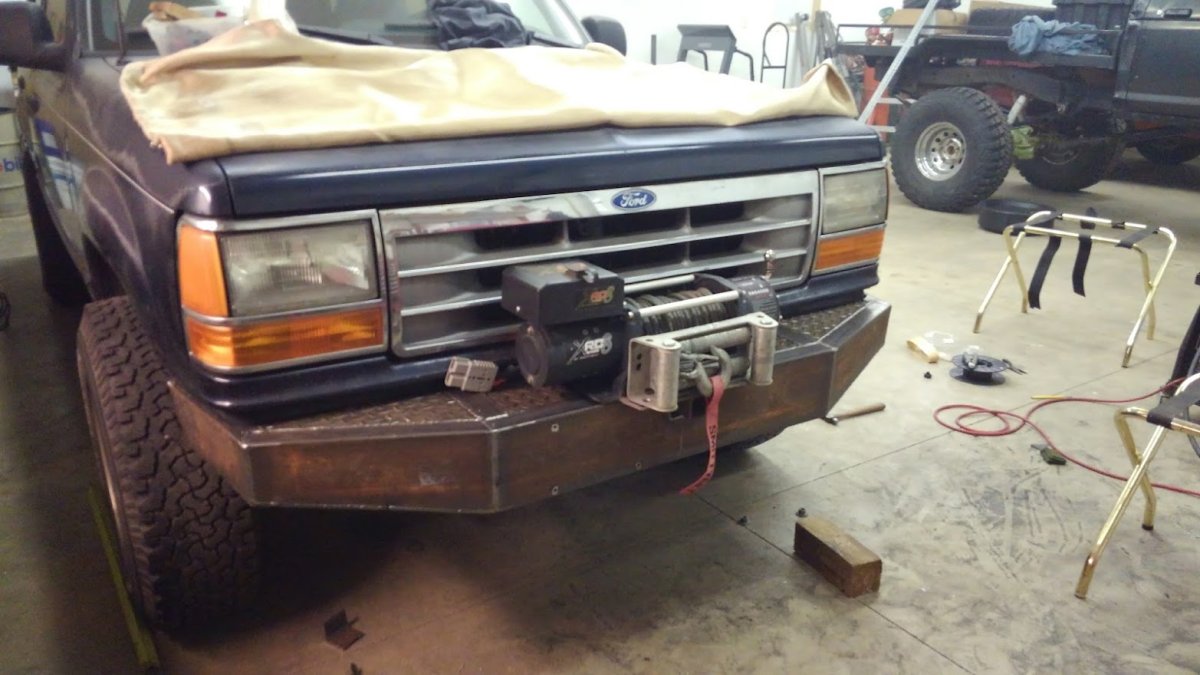

Or if your stuck on a bumper, build your own. Hit up you local metal scrap yard. When I built mine, bumpers were going for 1000 unpainted. I spent a 100 on scrap metal and 300 on powder coat on mine.
