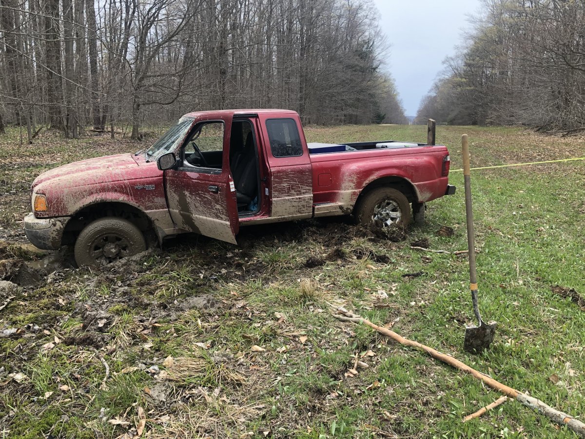

I've got a rear bumper from AOR 3/16". I wrapped a strap around it and drug it sideways about 20' through the mud with no issues.
Drug it straight sideways about five feet, and it kept digging in. Had to Jack it up and pile wood under it, then drag then front out. It was sunk up to the frame.
