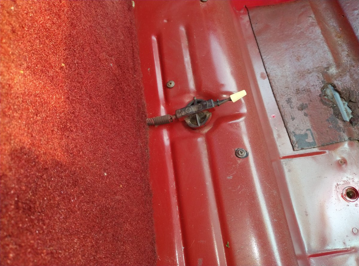

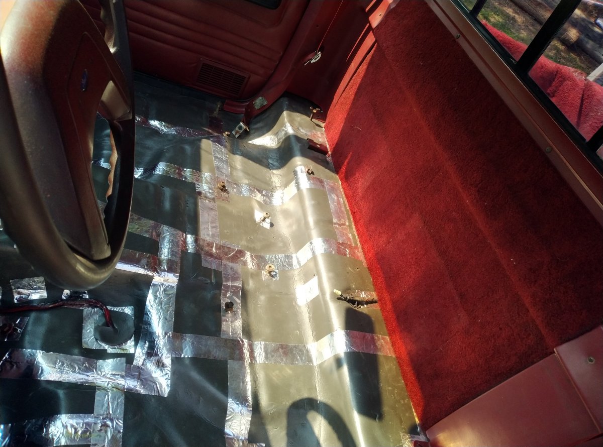

I'm doing the same thing. Ordered from OC today at noon (Vinyl). They Order from ACC. Ill see how the shipping is. Cost 185 total. here is what i have done so far. Dont know what the two wires are for in Pic3, the were twisted together so i left it that way. (BRN/BLU strip hot 12v tied to ground) Waiting on parts. Dirty

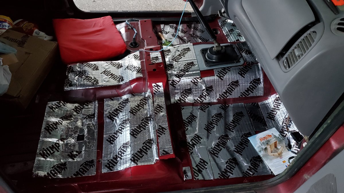

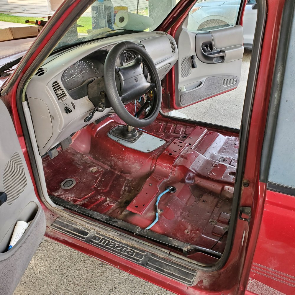

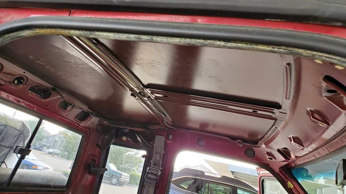

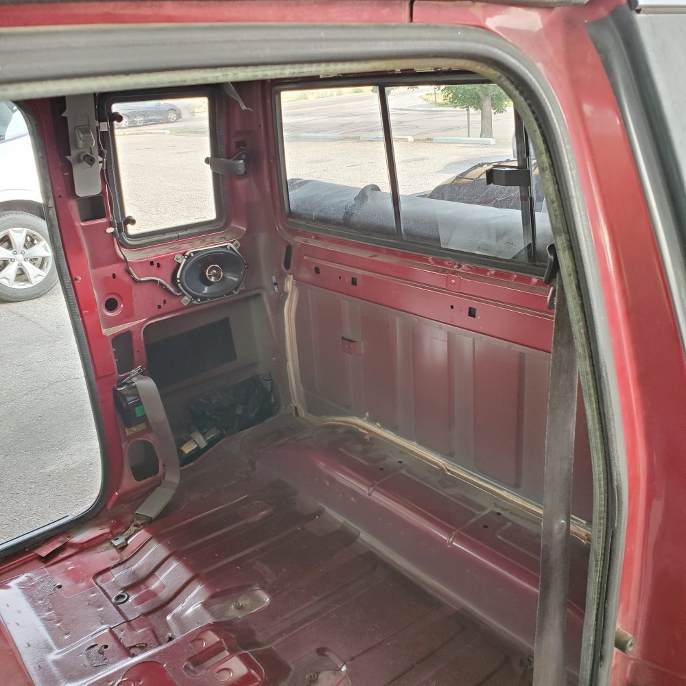

Went down the rabbit hole of doing a bunch of other fixes while waiting for the parts for the floor to get here, but finally got the interior gutted, cleaned and started putting down the first layer today. I opted for the 3 layer method with peel and stick, closed cell foam and MLV on top, then the vinyl floor.
My truck came with the Premium Sound option and I guess part of that was it already had a lot of noise dampening material on the floor and transmission hump. I briefly considered removing it but the stuff is stuck on like concrete. There's a way to remove it with dry ice but at I've read that might make the noise even worse so at that point I was like "screw it" and just laid the new stuff on top.

I believe those wires are for the seatbelt light on the dash. Someone tied them together to shut off the light. There may have been a buzzer as well? Not sure.
Thanks Bird76Mojo, sounds about right. Woogie you get your flooring yet. Dirty

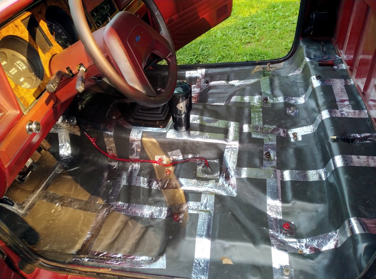

Ive thought about putting dynamat down before laying a vynil floor, my passenger footwell gets very hot, its noisy too but Ive gotten used to the noise. Maybe it would help in winter, always has been a icebox of a cab, I can keep the windshield defrosted but im rarely warmed up until Im at my destination.

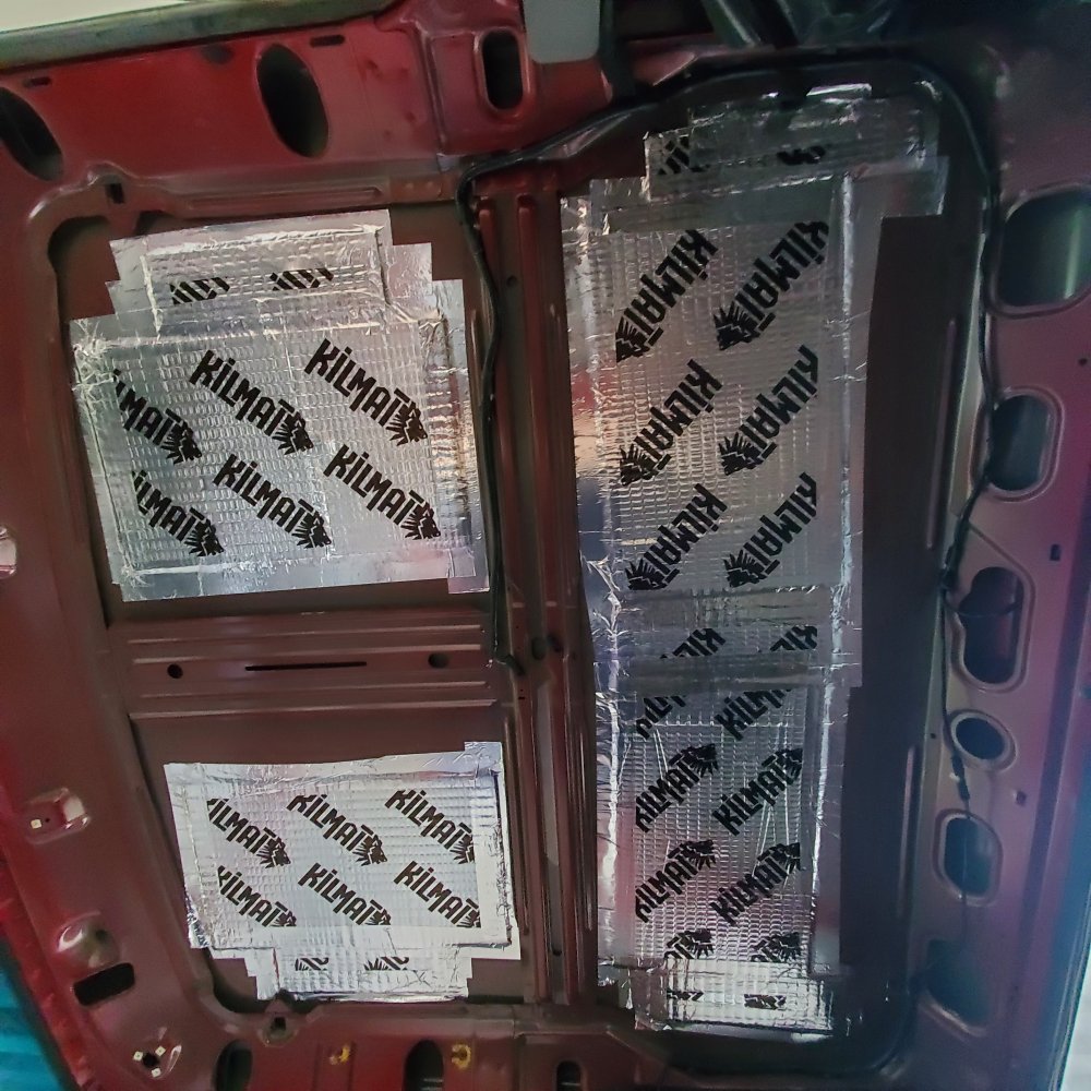

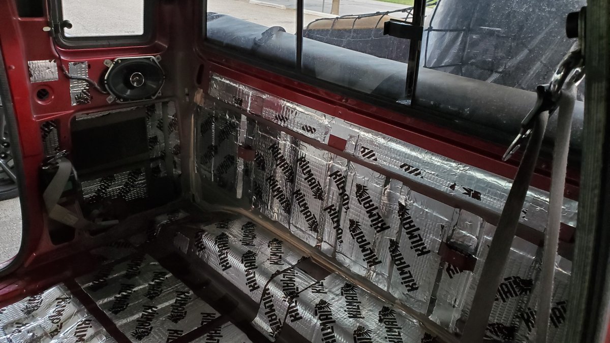

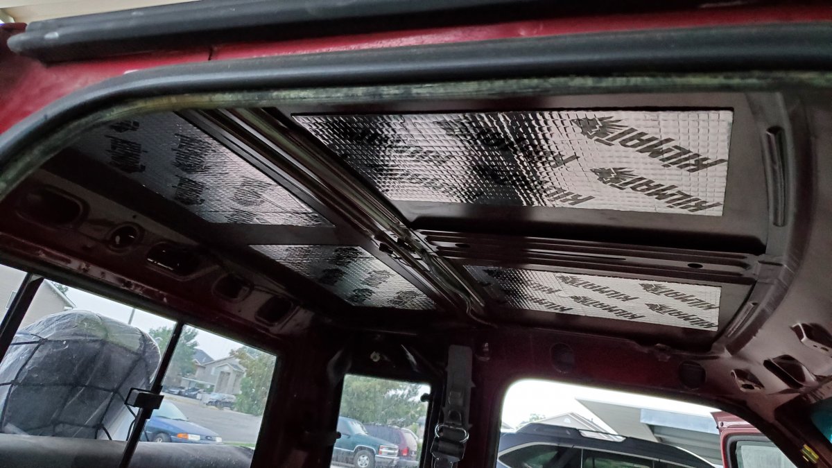

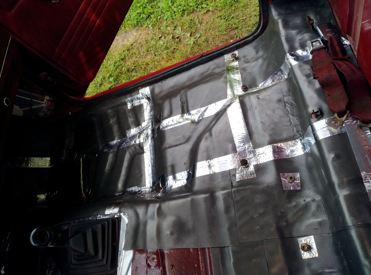

First layer is done. Some people cover every square inch with this stuff but after about 25% of the panel being covered you hit the wall of diminishing returns. So I focused on the flat areas of the floor, back wall and roof and had a few pieces left over to put in the sides behind the seats. I bought 36 square feet and ended up with 4.5 sheets left over. I think that will be enough to do the skin on the doors.
