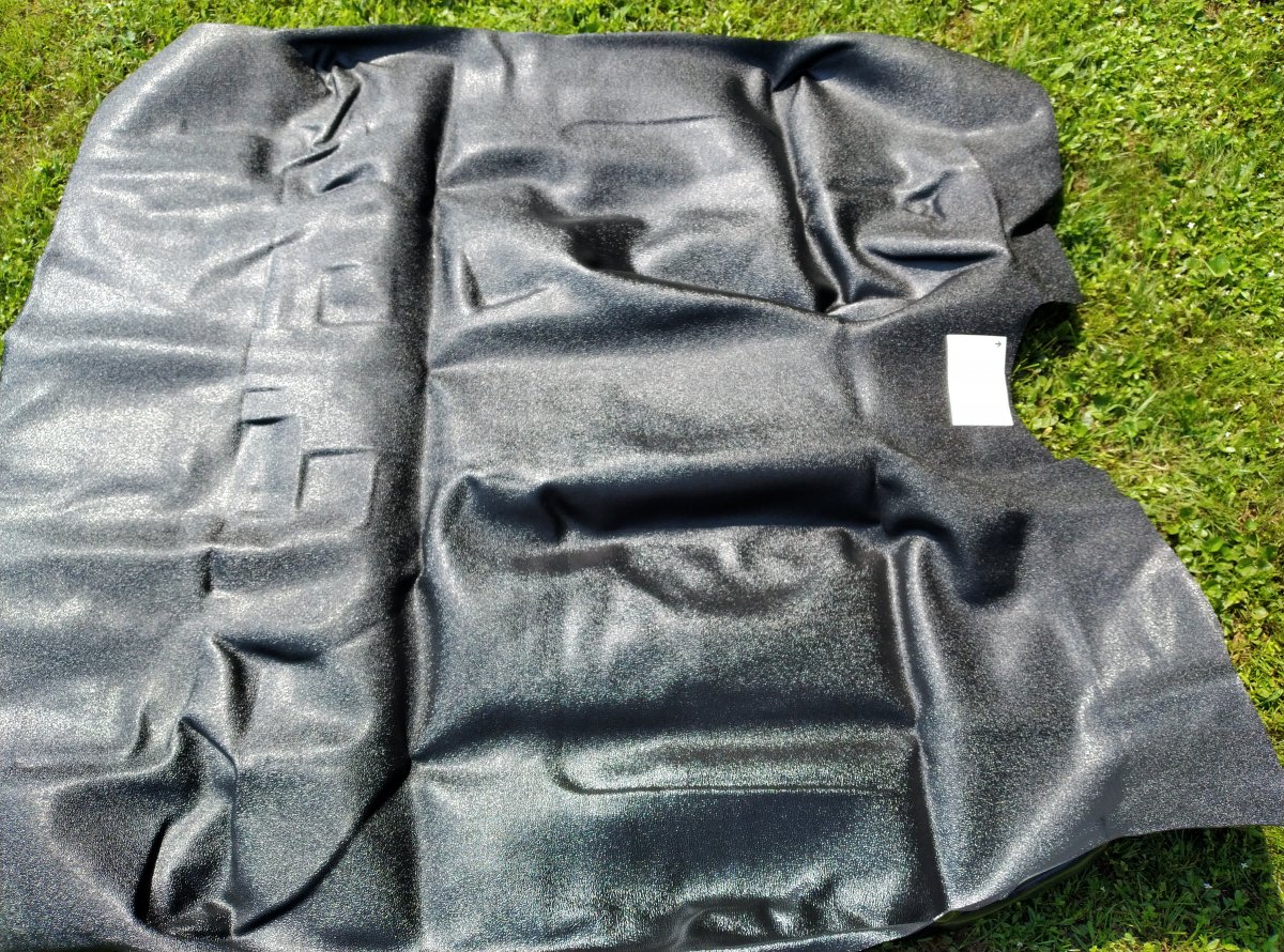

Found a package on the front porch this morning. Got it laying inside now after reading the only set of instructions there is. Looks pretty thick. Wonder if i have to wait 48 hours to install this? Dirty

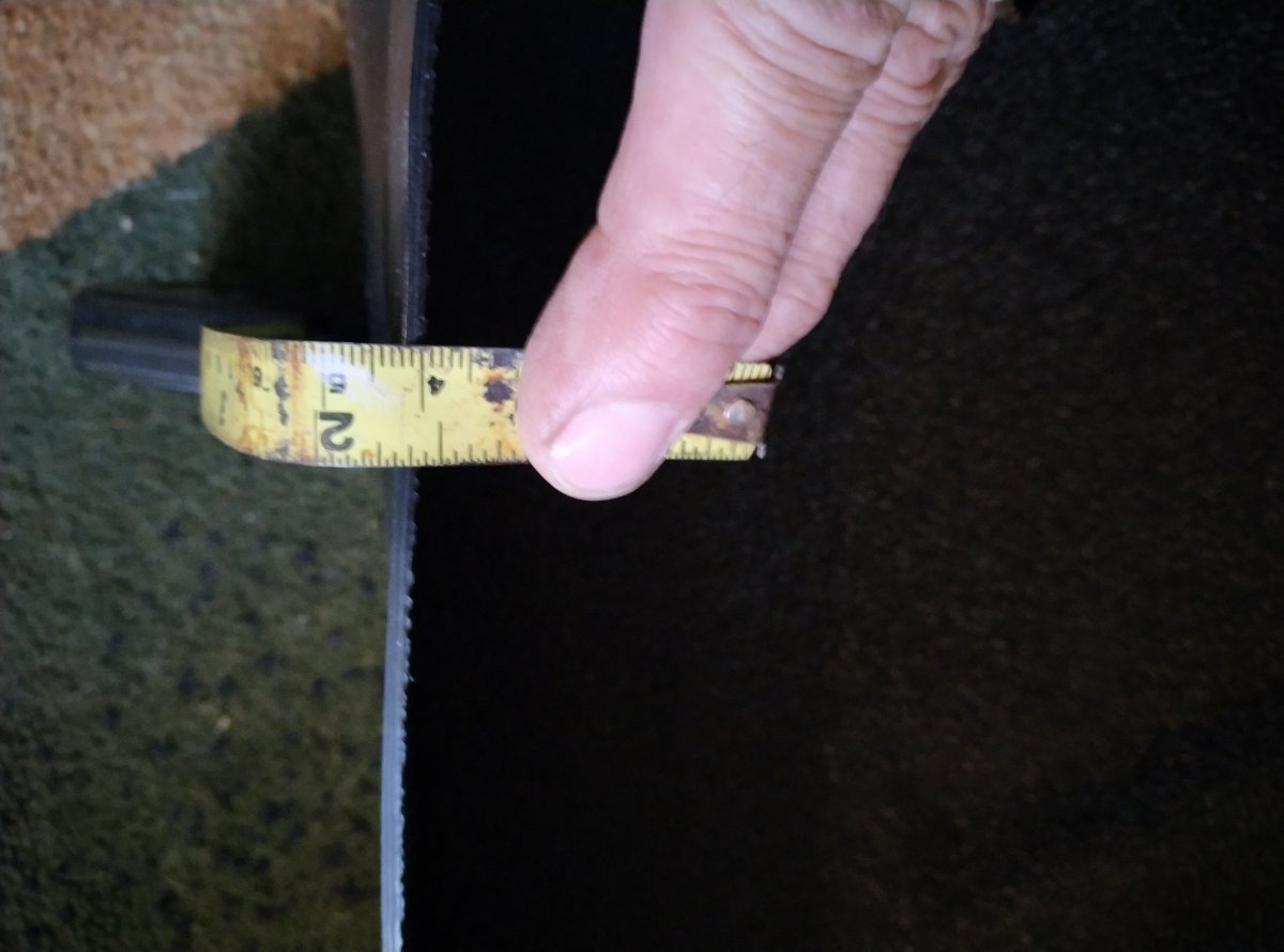

If you can, post up a picture of the thickness for us. With something next to it for scale maybe..
seems to vary a little when you come into contour's. Had no jute attached to it like carpet. Got it laying in the living room now. Wonder what happen if i install it earlier than 48 hours?
It would probably not line up right after installation because the creases would continue to relax. After you've cut holes and put back the bolts it couldn't expand, which would leave wrinkles.

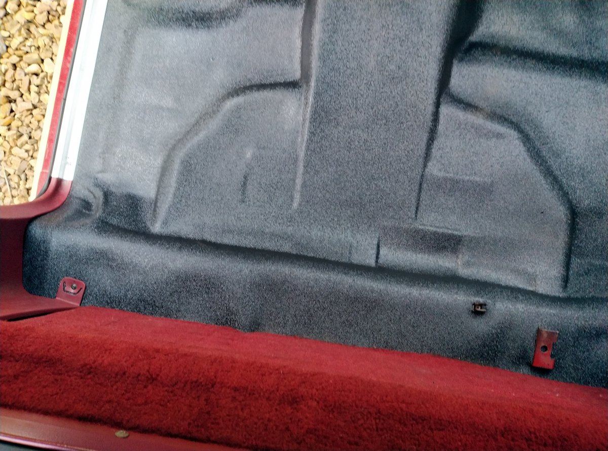

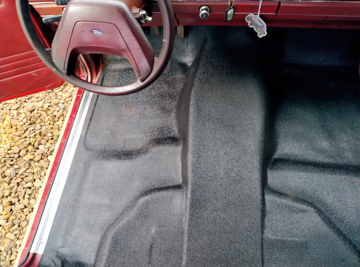

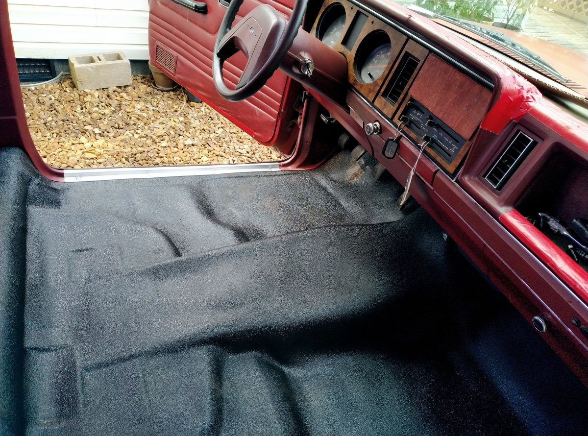

Cant do anything with it at 72 degrees. This is rigid stuff when at room temp. I had about 15 to 20 percent excess. Just kept trimming till it fit. The warm day made it easy to work with outside. Cut it big for the contracting process it will do when it turns cold. Start with the seats tomorrow. I took the shifter all the way out, just seemed easier. Dirty

Daaaaang, that looks nice! Where did you order it again, and how much was your total?
My 87 needs it badly. The factory vinyl floor is split all around the shifter.
Same place Woogie got his. He started the thread before me. ACC is the company. Looking for woogie for some pics. He has a 95 extended cab. The only problem i had is taking it in and out so many times my arms are sore but it paid off. This stuff is hard to train unless it is subject a heat gun or set it it the sun until its pliable. My total to the door was 187.00. Found out why the shifter is sloppy. I think Core shifters are back in business. Better order before they shut down.
