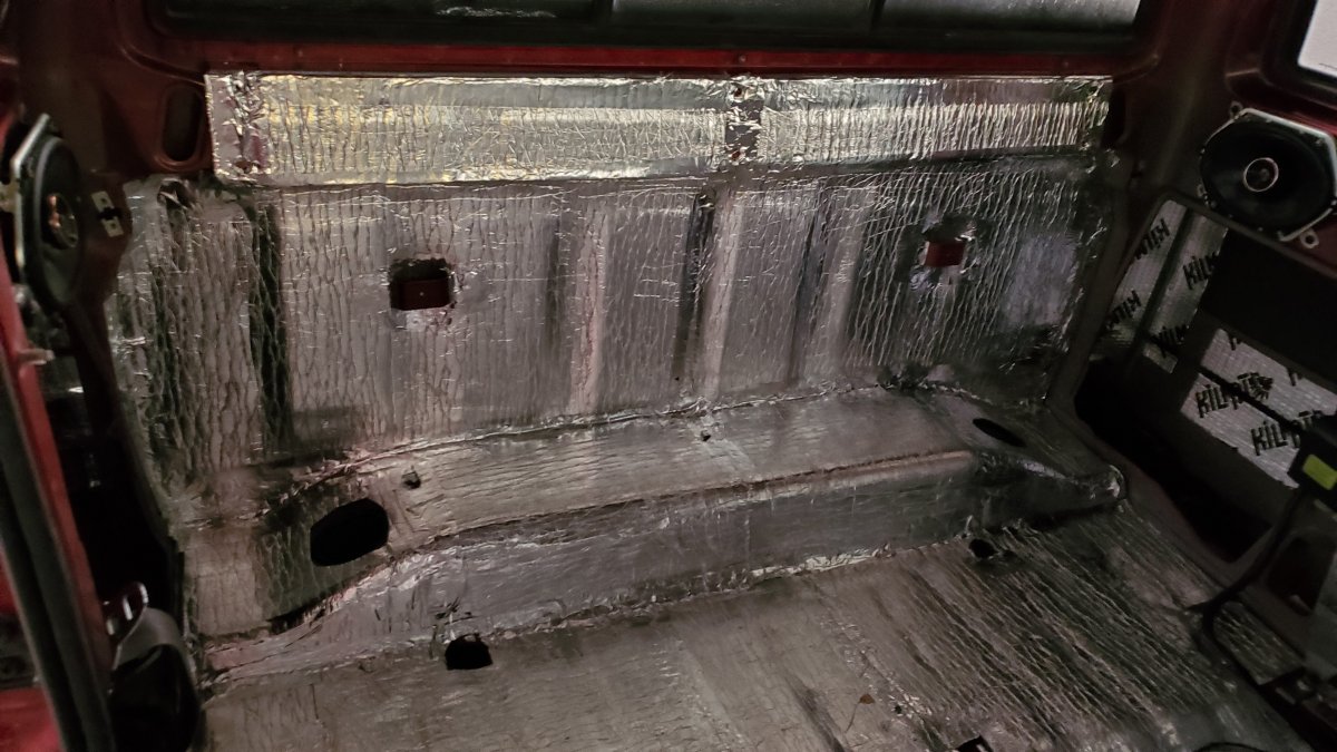

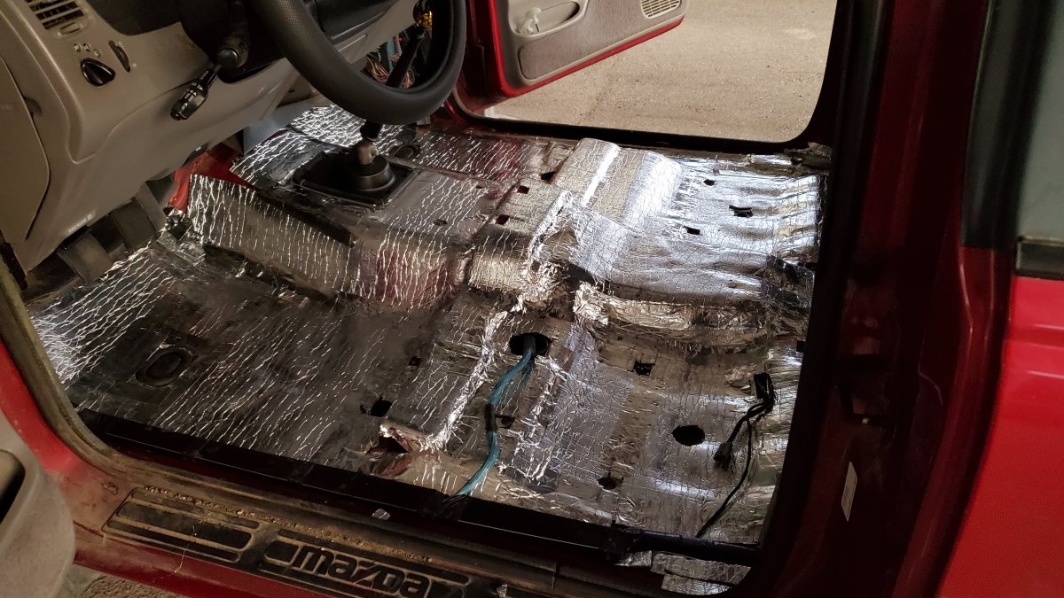

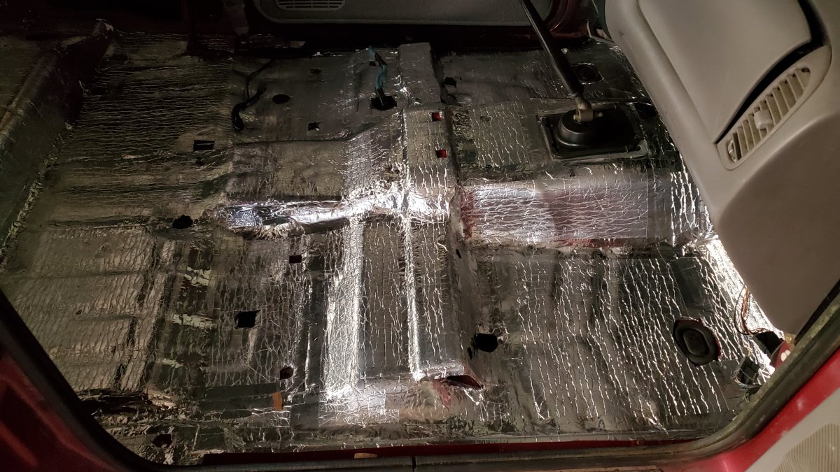

My little red tater. Second layer floor and back are done with the exception of some taped edges. I was probably way more meticulous about cuts and conforming to edges than I needed to be.
I'll make decisions about whether I want to do the extended area sides and around the edges when the trim starts going back on.
There's definite satisfaction in a job done well. You are doing this right, and I'm looking forward to seeing the finished results.
