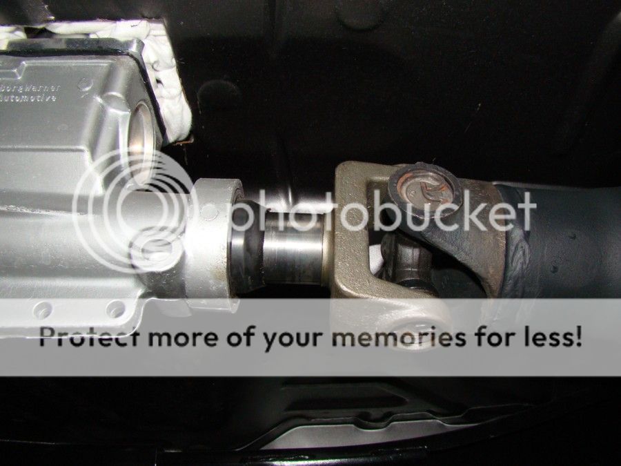

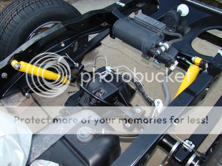

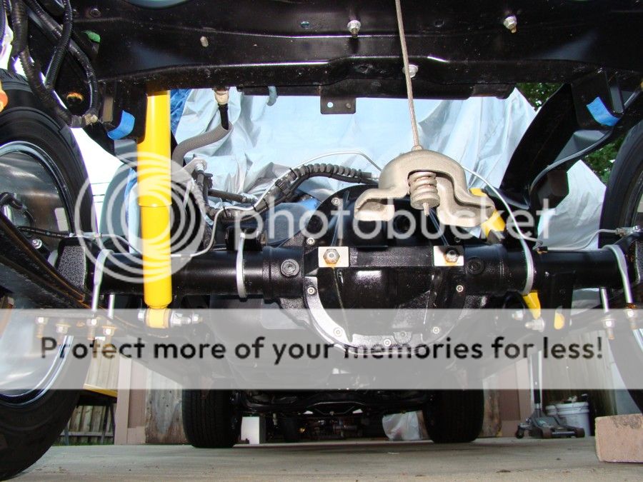

Friday I will be loading the truck up and sending it North about 45 miles to have the exhaust done. I have been working all week getting a few last minute things done so the truck can move under its own power. I ended up changing yokes on the drive shaft and it made the assembly just a bit longer. I didn’t like the way the drive shaft fit after the change so I went ahead and had about an inch taken out and then had it balanced. Prior to the change the yoke had very little clearance and was almost right up against the seal on the transmission. Now there is plenty of room for clearance as the suspension travels through its entire range of motion.

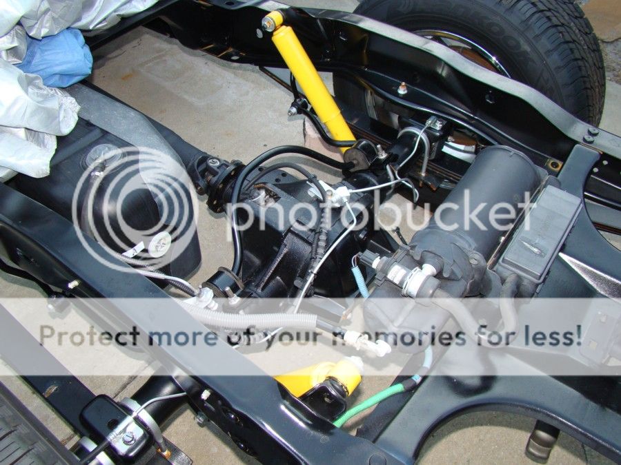

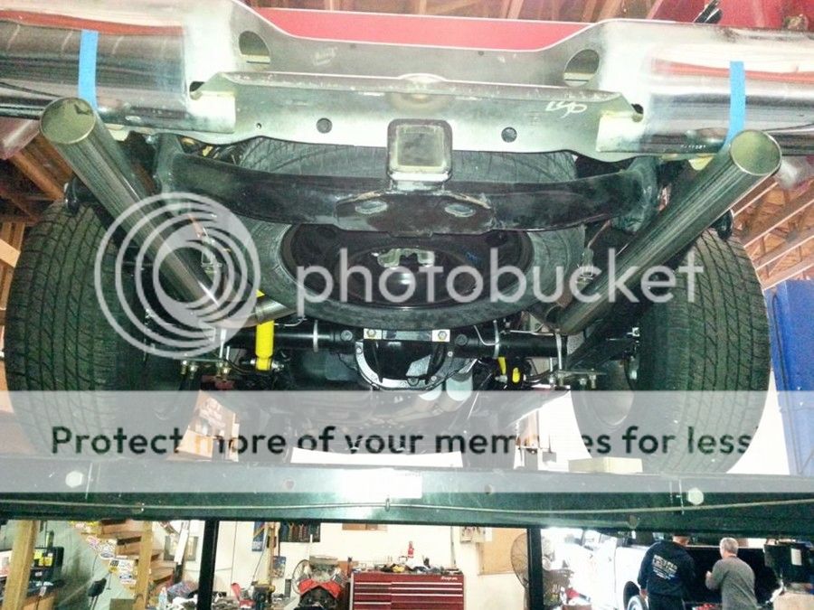

I also installed the factory rear sway bar, Curt receiver hitch, and rear bumper as all of these items will need to be considered when the exhaust is fabricated.

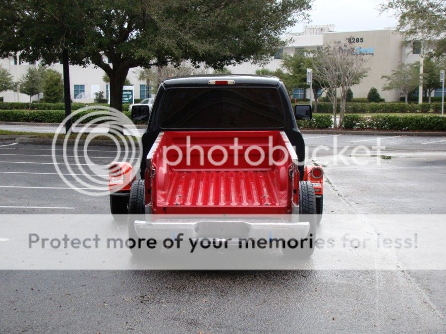

The blue tape on the frame brackets is just to let the installer know that they can be removed for clearance if needed. I hope to be able to hang a 17 inch Space Saver spare tire in the stock location.

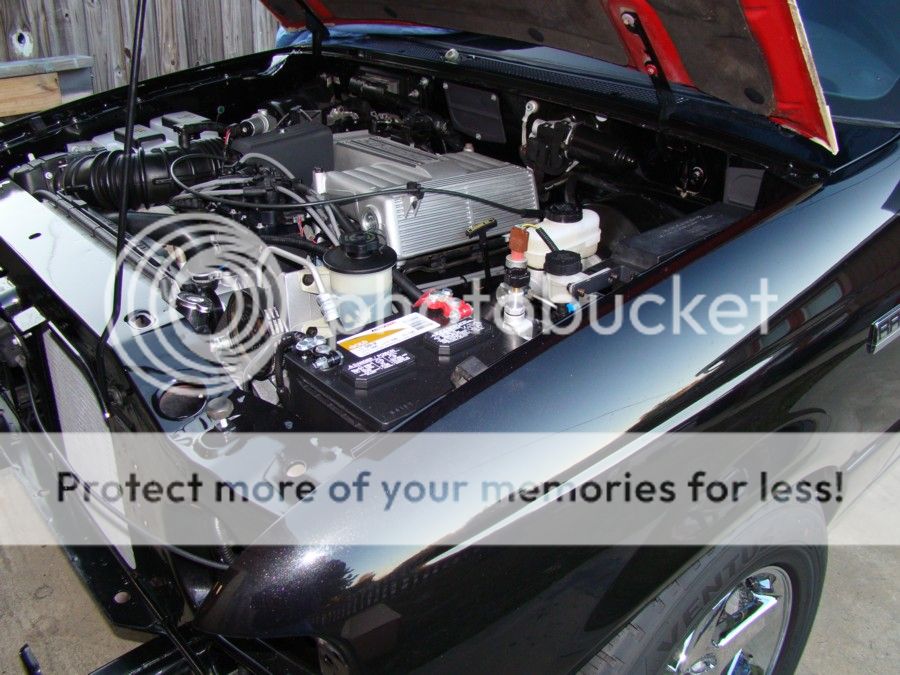

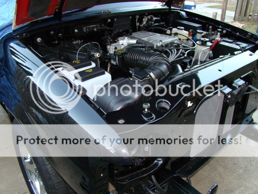

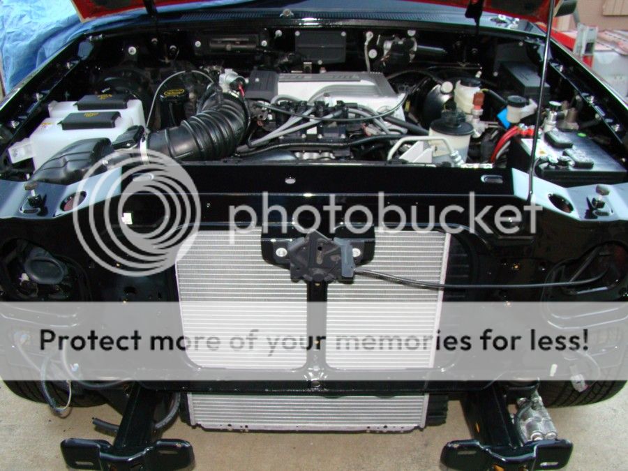

I also cleaned up a few items under hood, locked down the battery, installed the hood latch and cable, attached the driver side O2 sensor, moved the AC/Heater box slightly (header clearance) as well as sliding the body on the frame 1/8 inch to the right (header clearance).

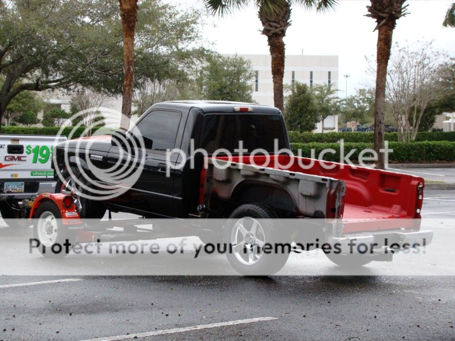

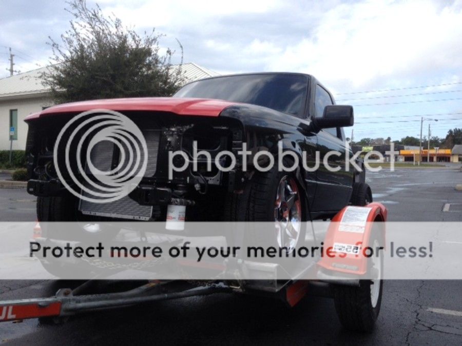

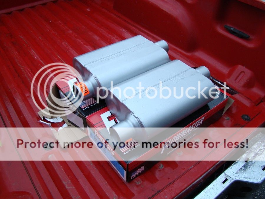

Today I packed up the new Flowmaster mufflers and drove the truck from the back yard and out on to the street where I loaded it on the tow dolly. After it was secured I headed north to deliver it to the shop that was scheduled to fabricate the exhaust for me over the next several days.

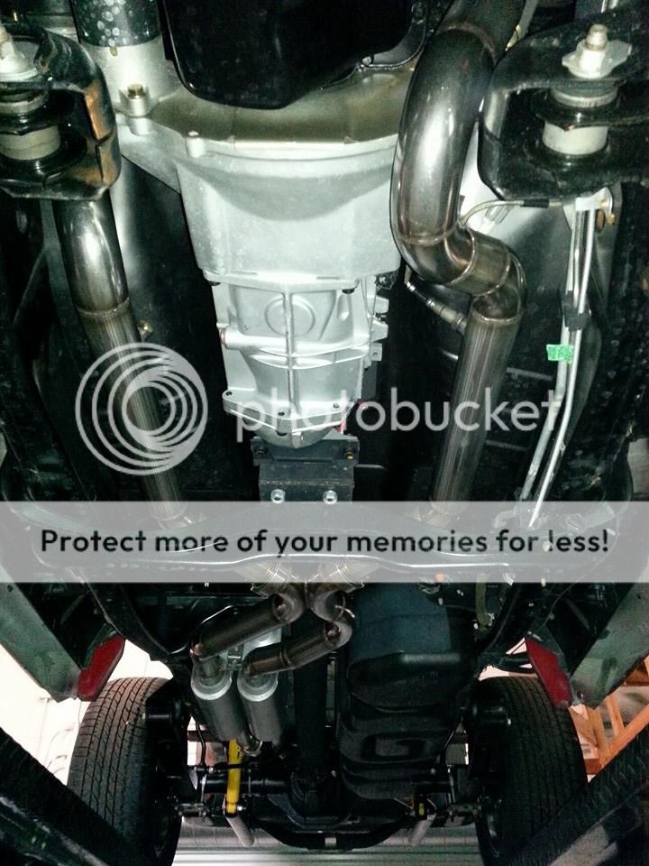

I got the call I have been waiting for earlier today. “The exhaust is done, come and get your truck”. That is all I needed to hear. I finished up an early day of work and headed out!!!
I will try to get a few more photos posted tomorrow now that the truck is back home. I just ran out of day light and had to rob most of these off the fabricators Facebook page.
Sorry about the dirty hitch, rear bumper, spare tire, and bed. All those had to be installed early for mock up purposes.

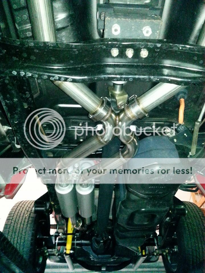

They did a really clean job and managed to fit everything I wanted, custom removable x-pipe/mid pipe, 2 ½ mandrel bent stainless steel, all wrapped around a 17 inch Space Saver spare tire, and no fancy tips, just raw stainless straight out the back.

Oh, it sounds good! I let it run for about 15 minutes and it came up to operating temp for the first time. I was pleased that nothing was leaking and the water temp sat still at 192 degrees. I just need to hook up the upstream O2's and it should be fairly complete as far as the engine goes. All of the codes have been corrected with the most recent tune except for the O2 codes.
