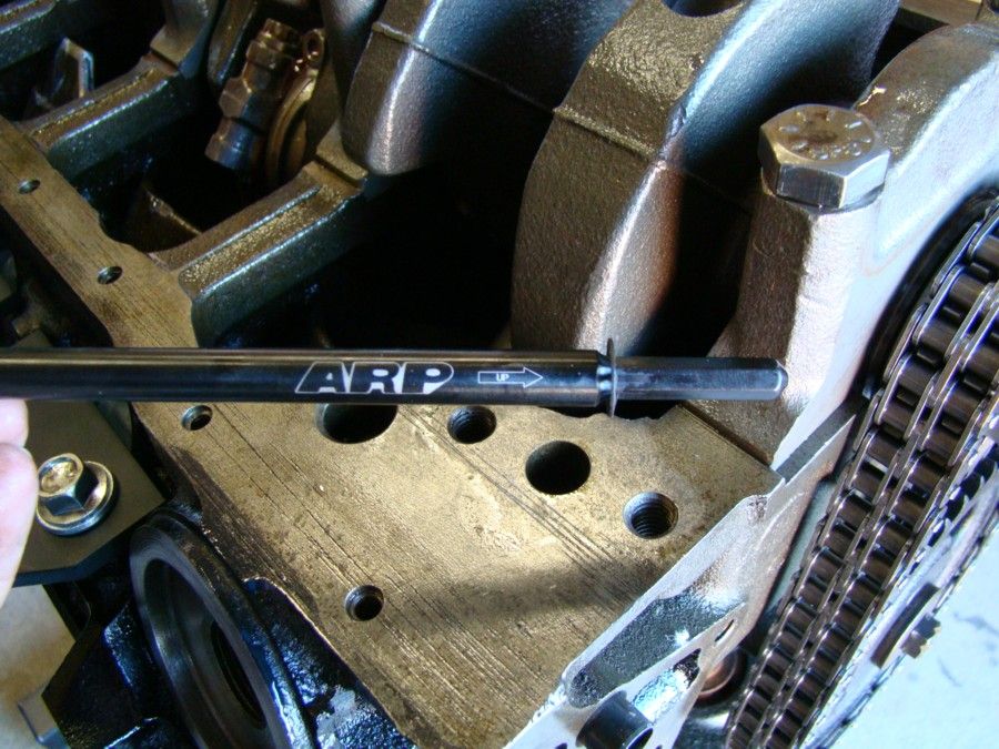

While the heads were drying after being cleaned and prepped for installation I flipped the engine upside down on the stand and installed the ARP oil pump shaft, oil pump, and oil pump pick up tube.

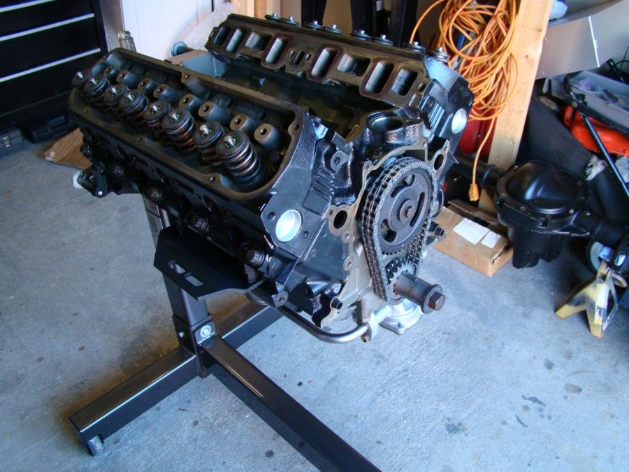

Once the cylinder heads were secured I decided to change out the engine plate fasteners for ARP pieces.

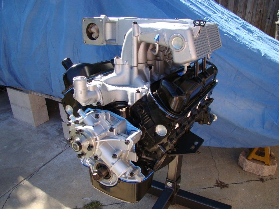

Now I hope the timing cover and water pump gaskets come on Monday so I can button up this part of the assembly process. It looks like another cool to cold and wet week so I may just keep moving and install the oil pan, upper and lower intake, and front accessory brackets before moving on to color sanding the cab.

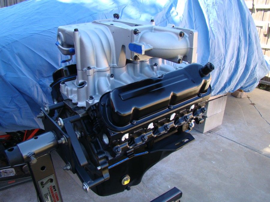

The new oil pump pick up tube didn’t come in today so I decided to move forward with some more mock up. Even though many of these parts will need to be removed for clearance when the engine is installed I still want to be positive I have the correct parts and everything fits together properly. I mounted the front accessory brackets, alternator, power steering reservoir, cam sensor, crank sensor, idler pulleys, tensioner pulley, and the Torque Monster Headers.

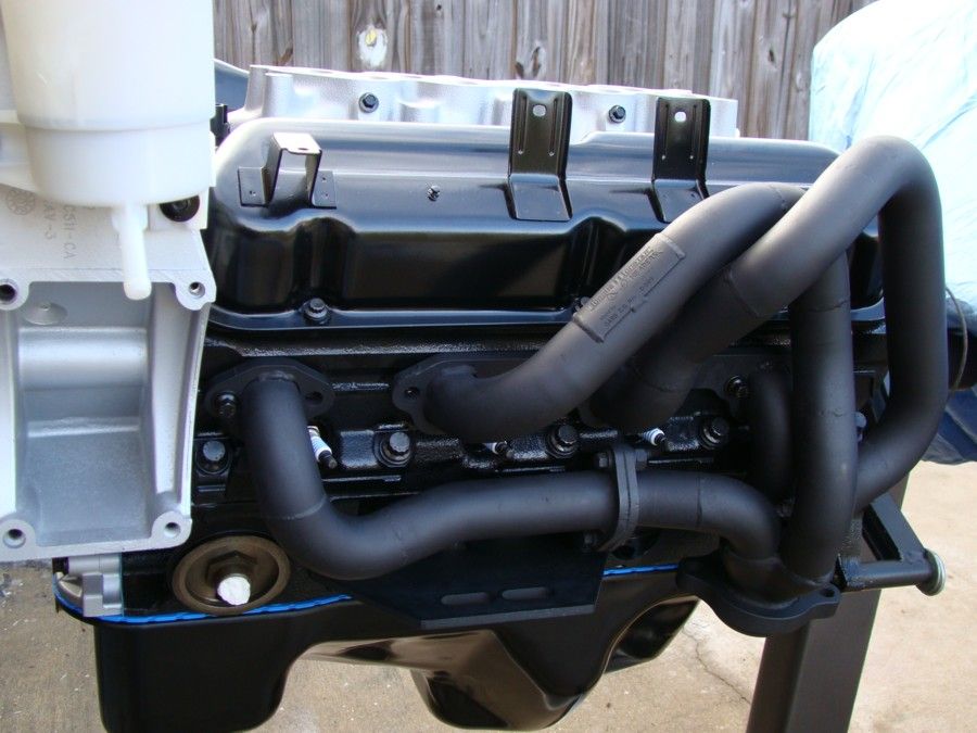

The right side header fit but there was some interference issue with the engine plate. A couple washers under the plate corrected the issue for now. I am going to wait to decide if I want to clearance the engine plate or raise the engine slightly with a permanent spacer. A forum member from another site working on a similar set up claimed that the oil pan didn’t clear the steering rack without a spacer. If I have the same problem I will add the spacer and not worry about clearancing the engine plate. If not I will probably go ahead and clearance the engine plate.

The left side header fit without issue. It looks like changing spark plugs should be fairly easy going through the wheel well. That is how I changed them on my first V8 Ranger but it had Tri Y headers and I wasn’t sure how this set up would be.

While I am sorting out the pushrod situation I am continuing to mock up a few finishing touches on the engine. Items like a new EGR Tube and EGR valve, OEM Motorcraft spark plug wires (not shown here), power steering pump, and water pump pulley (not shown here). I swapped out the incorrect oil pump pick up tube that would not clear the oil pan for an OEM piece and then double checked the clearance to the pan. Once the clearance was dialed in I went ahead and sealed up the bottom end and torqued down the ARP oil pan fasteners.

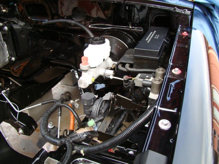

A few days ago I managed to get the power brake booster primed, sanded, and painted Satin black. Then I went ahead and installed it on the firewall of the truck and attached the brake master cylinder.

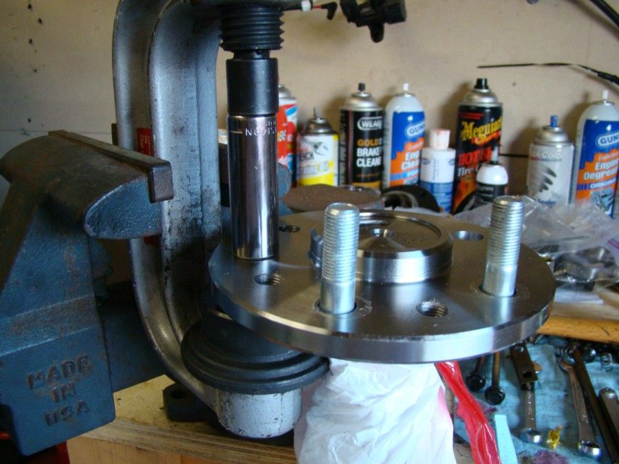

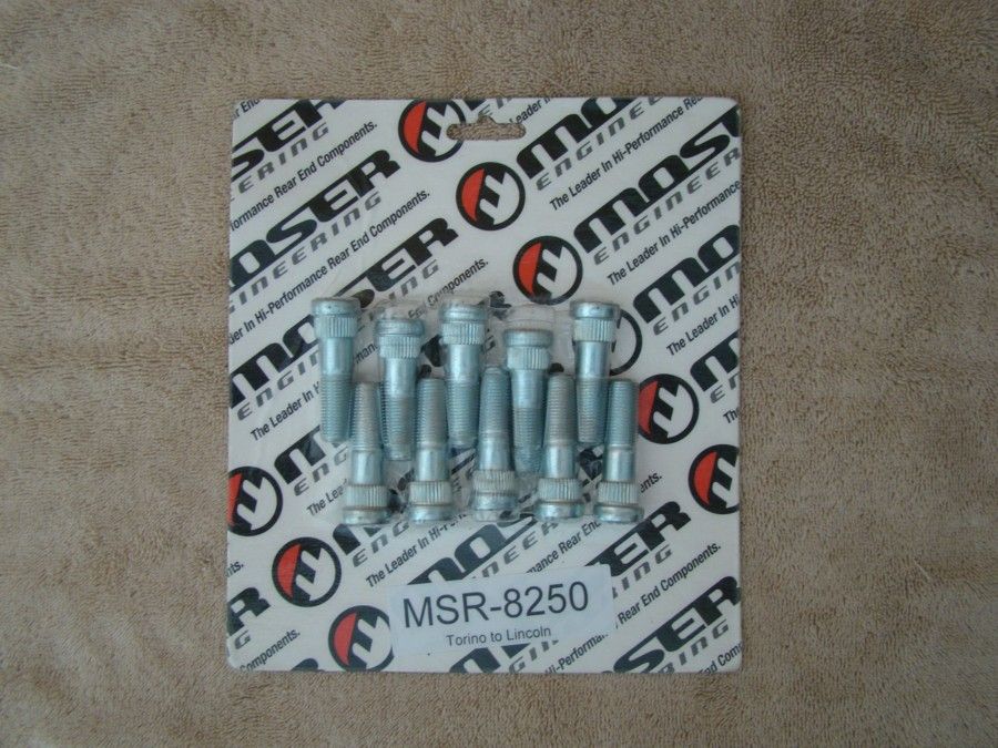

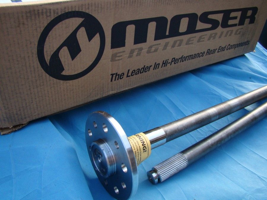

The 31 spline Moser axles and wheel studs arrived just in time for final assembly. I was excited to see these show up as they are the first brand new axles I have ever purchased.

I really need a shop press and a little more space. The small 12 x 12 barn is filling up quick leaving no area to work without shuffling things around. I ended up using a ball joint tool to press the wheel studs into the axles. It is times like this that you really appreciate that replacement warranty offered on all Craftsman tools!
One more 2wd 98 coil spring 5.0 swap.
Once the studs were in place the ends of the axles received a quick shot of clear coat to help fight the onset of rust.
