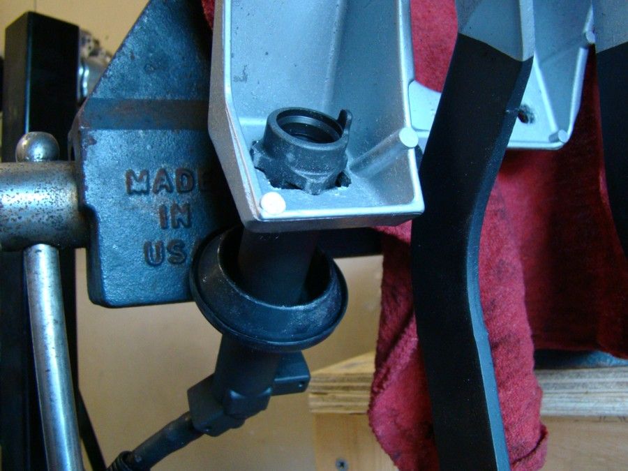

By enlarging the mounting hole in the pedal bracket I was able to mount the F550 clutch master cylinder in the OE location.

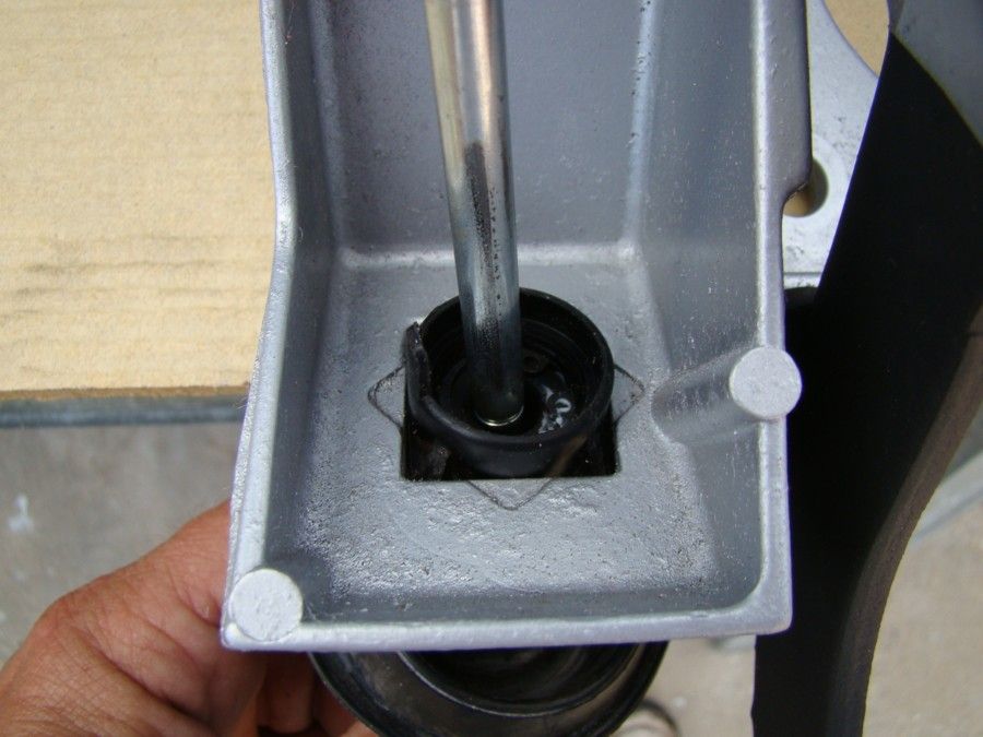

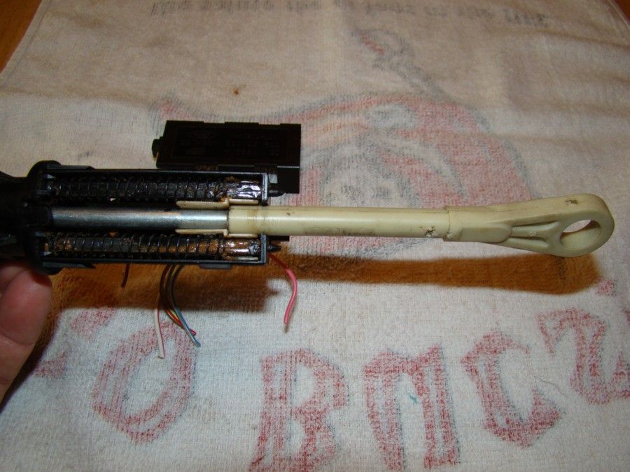

The first step to allowing a little more clutch pedal travel involved modifying the internals to the clutch switch.
One more 2wd 98 coil spring 5.0 swap.
I removed the switch cover so the assembly is visible.

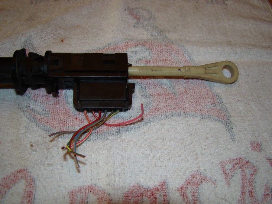

I then removed the pushrod from the assembly. You can see the white plunger that slides the length of the switch, currently 1 1/2 inch. I hope to modify this successfully to allow for an extra 1/8 inch of travel.
Next I removed the internal pieces and examined the interior.
I marked the three sides of the white plunger with a Sharpie so I could easily tell how much material to remove.
With a small amount of effort the excess material was removed from all three sides.
Now the pieces are returned to their original position.
It was difficult taking photos of the plunger compressed while holding everything else in one hand. With that being said you can see that the switch now allows for the added 1/8 inch of travel to match the total travel (1 5/8 inch) of the new F550 clutch master cylinder.

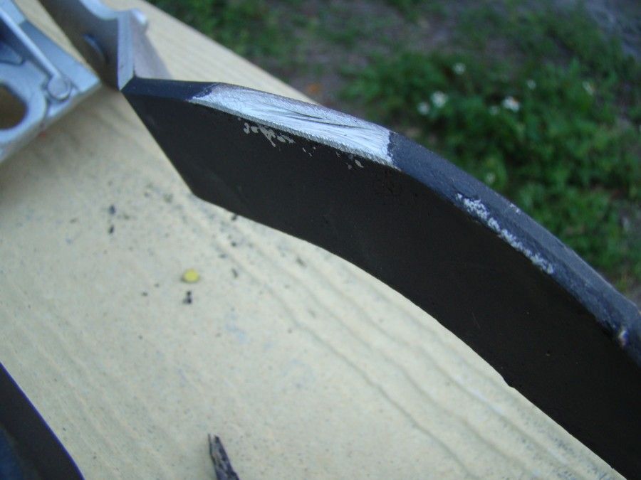

Next step will be a small amount of material removal from the back side of the clutch pedal where it contacts the floor pan and the rubber pedal stop.

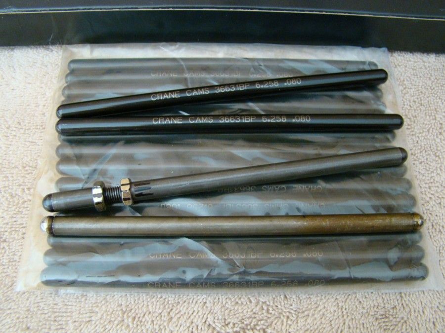

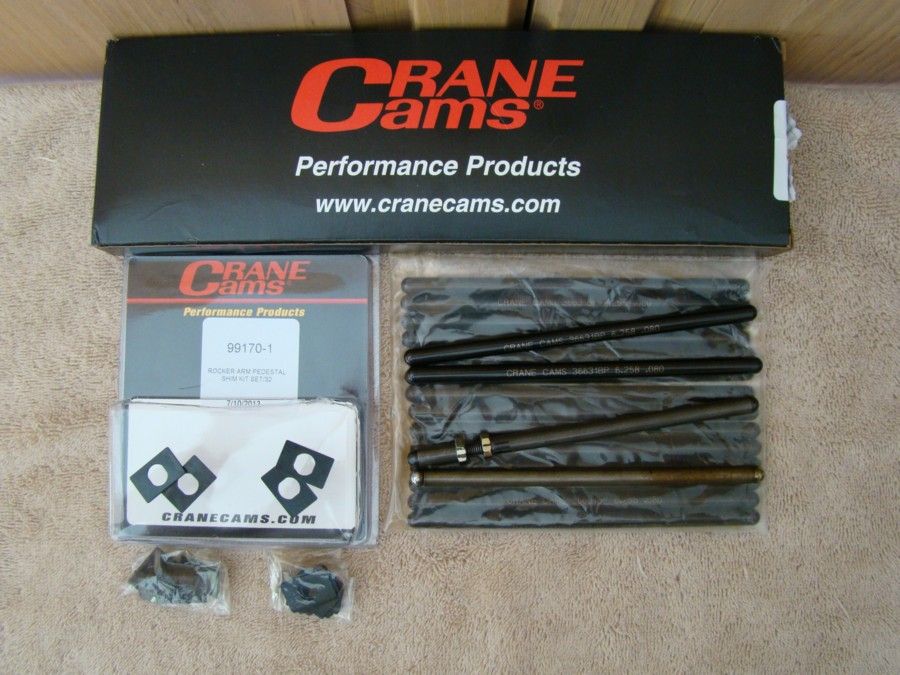

The pushrod length checker arrived a week or so ago and I mocked everything up once again. After carefully checking the valve train with the OE pushrods I came up with the same results as the first time. I hit 20 foot lbs of torque before any drag was noticed on the pushrod. In fact even after the desired torque was reached there seemed to be far too much play in the rocker arm. I replaced the OE pushrod on the number one intake valve with the pushrod length checker and adjusted it to where I felt a slight drag and then rotated the rocker arm bolt ¼ turn before hitting 20 foot lbs of torque. I repeated the same procedure on the number one exhaust valve and achieved the same results. I doubled checked my findings on several intake and exhaust valves and felt comfortable with the final adjustment of the pushrod length checker.
I do not have a micrometer or digital caliper large enough to measure the pushrod length checker so I stopped by the machine shop and had them measure the OE pushrod and the final adjustment on the pushrod length checker. They came up with 6.250 for the OE pushrod and 6.258 for the pushrod length checker. I went ahead and ordered a set of 6.258 inch Crane Cam pushrods and a Crane Cam shim kit.

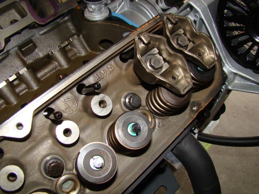

I covered most of the rocker arm assembly procedures earlier in the thread so I will just go ahead and post a couple quick photos of today’s process and skip repeating the boring stuff.

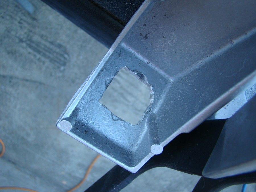

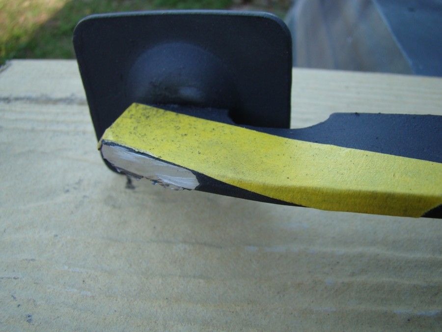

I identified two areas on the back of the clutch pedal that contacted both the floor pan and the rubber stop. I marked the two areas that I wanted to remove excess material in order to create the additional 1/8 inch of travel.
I took a grinder and cut the excess material off with little effort.
Then I cleaned up both areas with a file and the back of the pedal was ready for a quick shot of flat black paint.

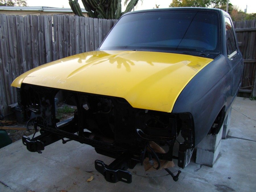

I also went ahead and test fit the 2011 hood panel. I wanted to make sure it lined up well and that the hinges didn’t need any adjustment or modification. I can't believe how heavy this hood is compared to the 99 hood. I bet it is twice the weight.

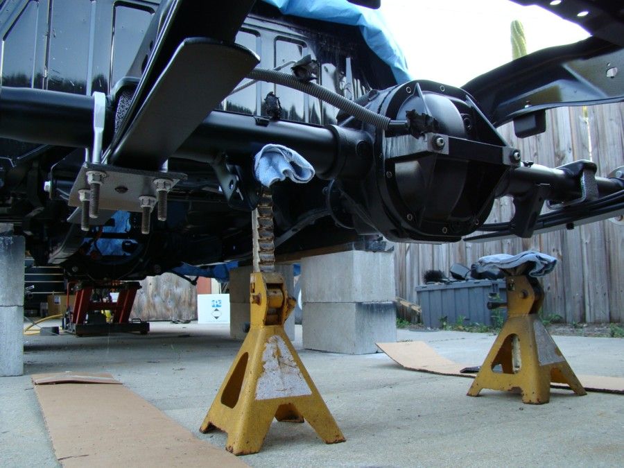

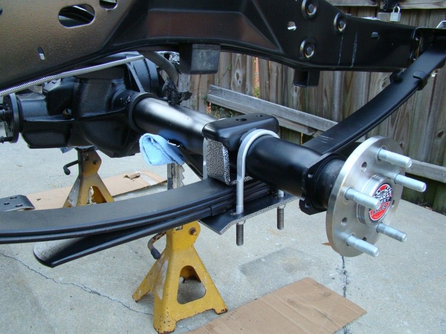

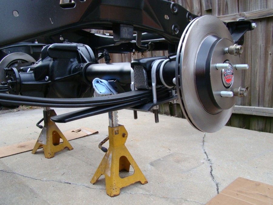

With the help of a few jack stands I set the rear end in place so I could temporarily attached the leaf springs to the rear spring perches. The shackles are not ready as there was a problem with the bushings I received. The correct pieces are on the way and should be ready to install soon.

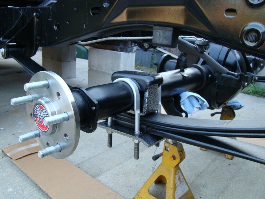

I started running out of day light but did manage to install the flip kit and U bolts on the driver side. I used a few pieces of paper towel between the U bolts and the housing to help avoid any new scratches during the installation.
Once the slack was drawn up on the U bolts the paper towels were removed.
Tomorrow I will button up the passenger side and trim the excess off the U bolts then torque everything down. That will leave the shackle bushings as the only remaining piece of the puzzle. As soon as they arrive I will go ahead and press them in and install the shackles.

Tonight I mocked up the Ford Racing M-2300-M Cobra Rear Disc Brake Kit. Because the Ranger rear end specs are slightly different than the Mustang rear end specs the caliper brackets require slight modification so they can be installed behind the housing flange. The Mustang set up allows the caliper bracket to be mounted on the outside of the housing flange so it can be slipped directly over the end of the housing without modification.
I had a diagram on file that I had saved a few years ago that assisted with the modification.
Once the two brackets were cut I went ahead and bolted them in place followed by the anti-moan brackets and finally the 11.65” Cobra rear disc.
I have my eye on a new set of 03 Cobra rear brake calipers that would look real nice mounted here. If all goes well I will be pulling the trigger on those in a week or two.
You weren't that far into the axle build, why not leave the bracket intact and bolt it up when the axle shafts were out?
