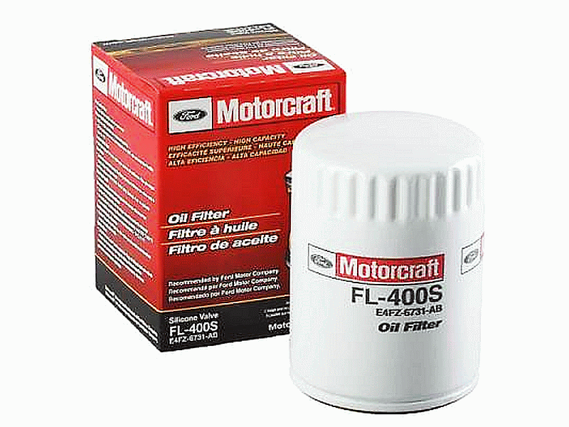

Is there a Ford (or any) vehicle whose oil filter is interchangeable with a 2002, 3.0L, Ranger...? Store had no filter book only the digital video game look-up box. Showed all trucks, all years, no Rangers. Will anything else fit...? It's a convenient store as I live in the boonies. Thanx
Motorcraft FL-400S
Any year Taurus that uses the pushrod 3.0 (vin U)
According to this link: Filter for 2002 Taurus w/Vulcan V-6 | Bob Is The Oil Guy (scroll down to post #5), Ford Taurus (as noted by Holyford86) uses the same filter as your Ranger.
2002 Ford Mustang 3.8L
2007~???? Ford Edge or Lincoln MKX V6~3.5L~DOHC
uses same or crossref'd OilFilter as a 2002 Ranger V6~3.0L
FordMotorCraft# fL400s
