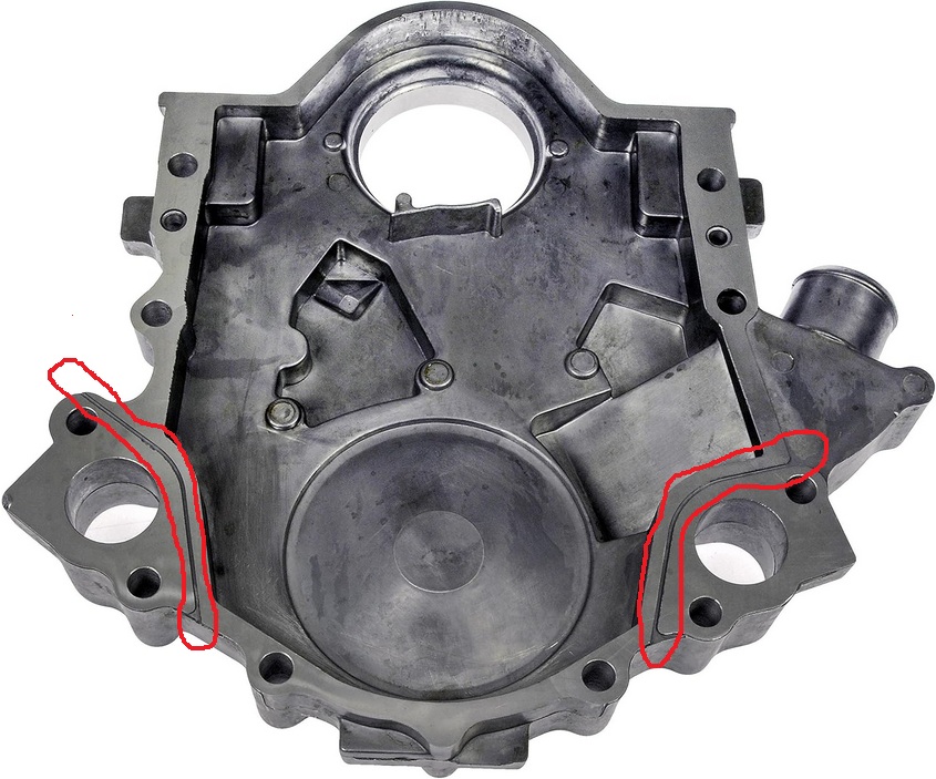

Not sure what’s up with the thing you circled, looks like a gasket that blew out but it should be leaking a lot more of that was the case.
Doing a little study, it looks like Ford did have the foresight to leave 2 "escape channels" in the mating surface of the TC cover, so that coolant can leak off to the sides before it gets into the oil, and one of those outlets is what I circled in red... which makes me wonder: if my Permatex jury-rig works "too well", will I just end up FORCING coolant into the oil? 🤯 (Oil looks fine now, zero contamination...) Pour some Acme Stop-Leak into the radiator????

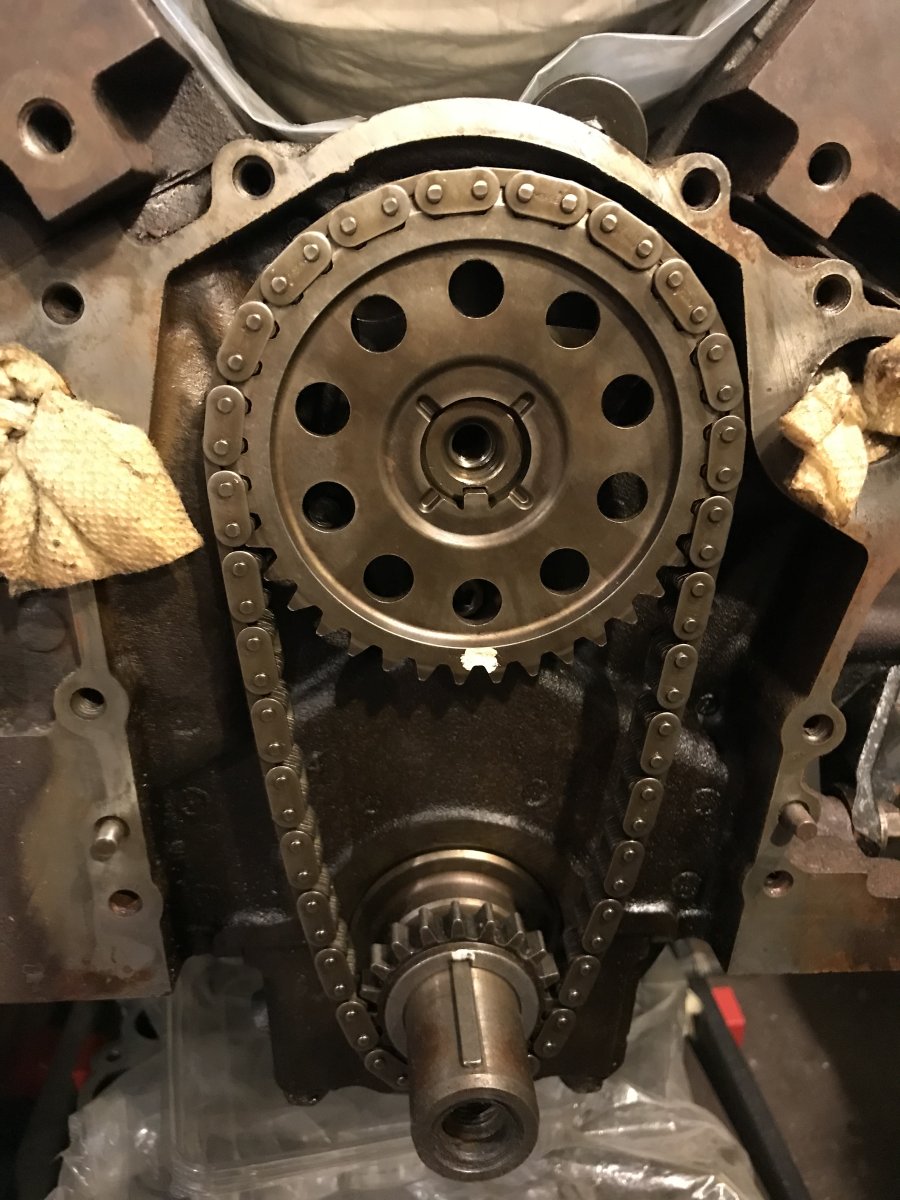

if you do not remove/mess with the cam synchronizer unit timing is merely aligning the dots.
it helps, but is not necessary, to set the engine at TDC before you start.
once the timing cover is removed the chain & gears are exposed, and you can see the timing marks.
now you can turn the engine over and align the dots. big gear points down, small gear points up.
then replace the gears/chain and put them back the same way.
the cam will have a tendency to jump around, just rotate it back to where you need it to be.
there are small dimples under the white spots.
line them up exactly like this.
when the small gear is pointed up the # 1 cylinder is at TDC.
yes, the camshaft bolt is missing.
