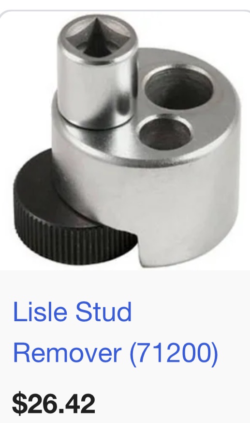

Might want one of these handy View attachment 135837
Well dang it, man, TRY to remember!... :D;)
(Are you posting the stud-remover because of the bolts which pass through the coolant channels?...)
