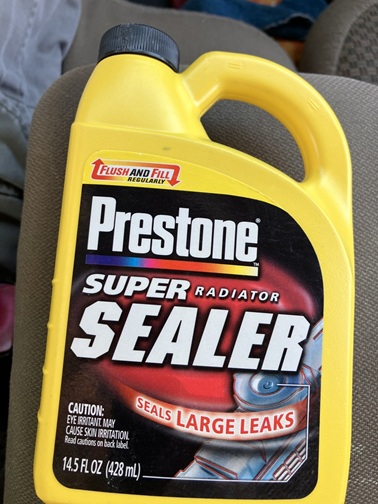

Holy Magnesium Aluminum Sulfate Batman!... that discontinued mystery McFormulation worked!... for now... <knock wood>

... and the heater stills works, so it didn't clog up the core either!

Not gonna lie, there's some residue in the bottle pictured above that looks exactly like coarse-ground black pepper!... even after rinsing it with coolant to top-off the radiator, there's still some granules in there--they must be dense!

I wonder if the FTC forced them to stop selling this because it's just overpriced black pepper?... :LOL::unsure::oops:
OK, so now, with da leak-stop "stuff" circ-u-malating around my cooling system, what do I have to be careful of? Does it have to remain in there?
Can I use flush-stuff at hose-change time? Is there anything that will UNdo the leak-plug?
Fill me in, I'm in Fook-Mi territory, and her twin sister Fook-Yu is nowhere to be found! :icon_confused::icon_twisted:
They claim those particles are Kevlar. Assuming that's true and the mechanism of sealing is by jamming Kevlar particles into the leak, you're probably fine leaving it in there. The ones that work by hardening when they come in contact with the air have a tendency to gum up over time. If there's some of that in the Prestone that would be my worry. If the instructions don't mention flushing it out, you might as well leave it alone - the extra particles floating around the system will probably continue to seal the leak as the initial patch wears off.
