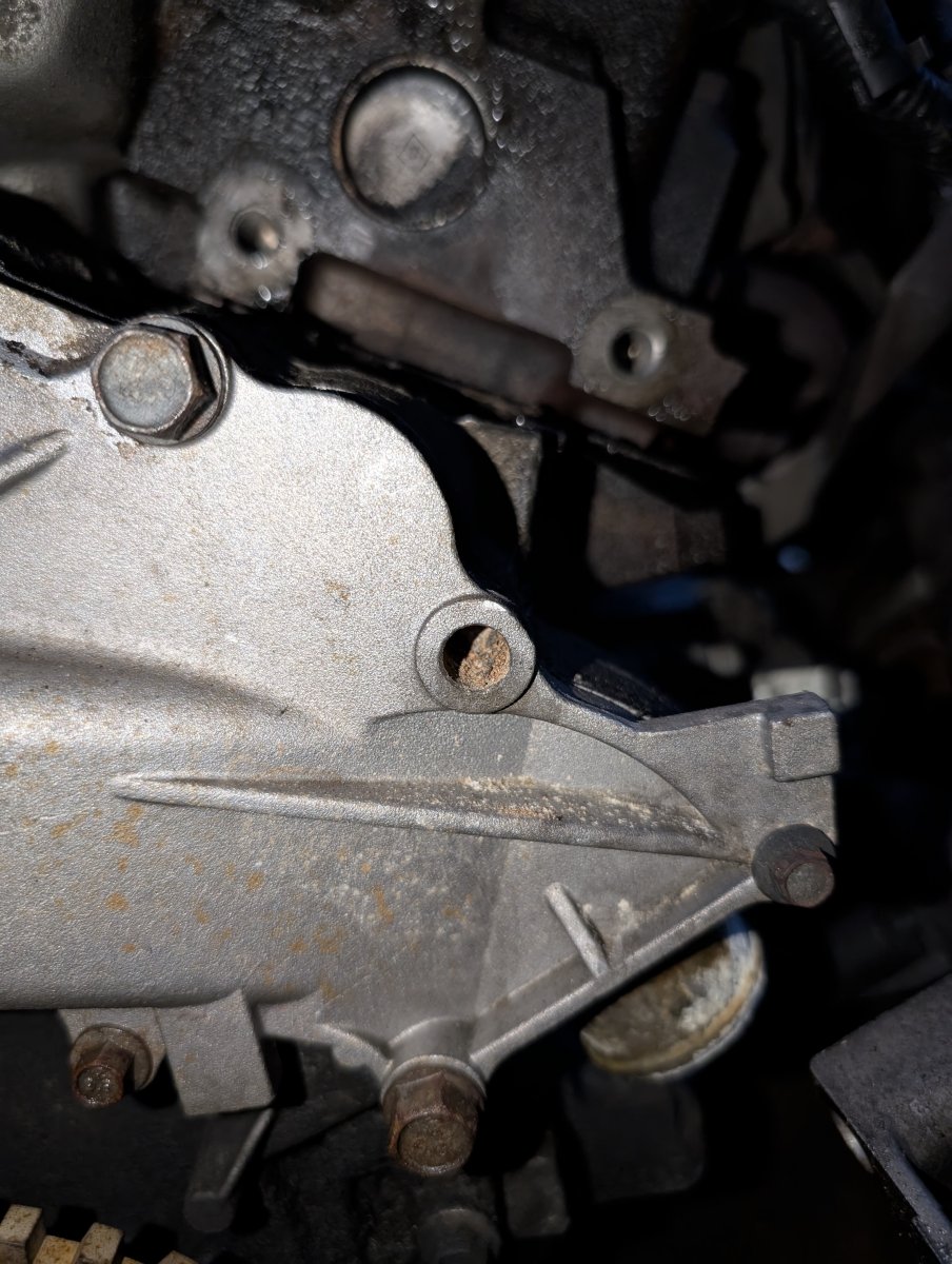

My timing cover was pitted - I can't say how badly compared to others but it was pretty bad - but not bad enough for me to spend $250 on a timing cover. I wasn't going to even attempt to use a dry gasket (which I normally advocate) given the work to get in there. I used a very thin layer of Permatex Ultra Black, thin enough that there was zero squish-out when everything was torqued down, but things are bone dry after several heat cycles entering day 3. If it ever leaks, I'll update this thread.

This is to give context to what I think is important: in my case, the timing cover was pitted in such a way that the main leak was in an almost perfect spot to leak externally, but it was getting ready to be a problem in several other spots. I can't see any reason why it wouldn't just be luck of the draw and you might end up with the coolant leaking straight into the oil pan. At a quart an hour, you can imagine what state the engine would have been in pretty quick.

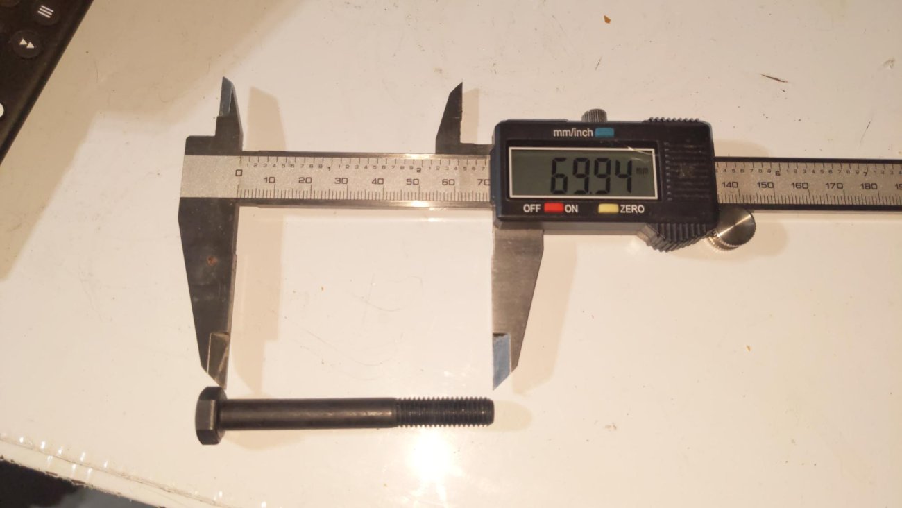

However, I found good quality replacements at a local fastener store. They're a fairly common metric size and thread pitch. I'm sure you could find all the others too with the possible exception of that really weird one which is like a 10mm bolt with a 17 or 19mm head on it. If anyone knows why they did that I'd love to hear it. At any rate that one was in fine condition on my truck.
EDIT: the reason I bought replacements was because mine looked so bad when they came out I was sure I wouldn't be able to reuse them. I was really surprised how well they cleaned up with a wire wheel. I posted a picture and the specs of the problem bolts in another thread here a little while ago. If I can't find that thread I'll go and measure them again tomorrow.
