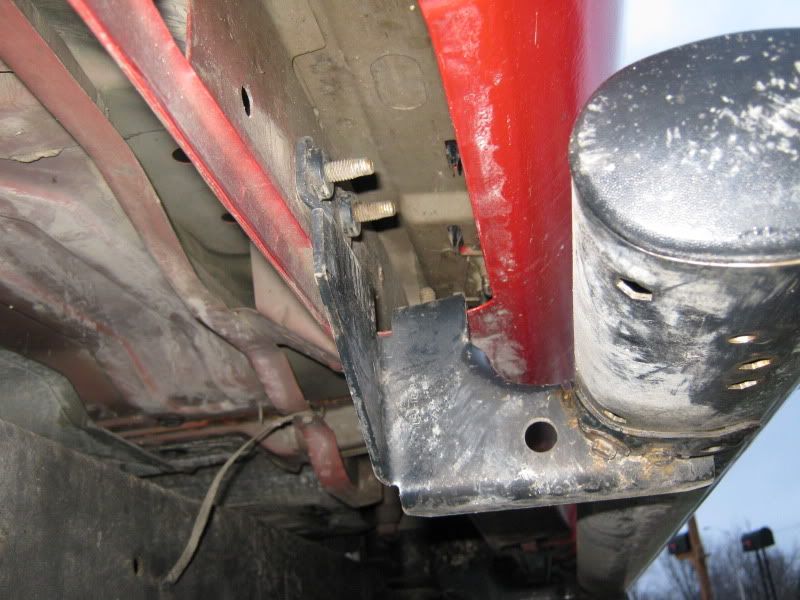

Here's a picture of the 2 door rear brackets (the bracket on the right). Notice they're a 2 piece design.
The 2nd picture is a passenger side bracket. The Y shaped bracket bolts to the rear or the cab by the bed and to a pinch weld under the cab. It seems common that people leave the 2nd bracket on the truck, not realizing it goes with the step rails. So if you're looking for step rails make sure you get both pieces.
Here's a picture of the 4 door rear brackets.
These are a 1 piece design. You'll notice it bolts to a pinch weld under the cab and part of the bracket points to the front of the truck. This part of the brackets mounts to the cab, which is a little different from the 2 door cab. It's hard to explain so here's another picture that might help
