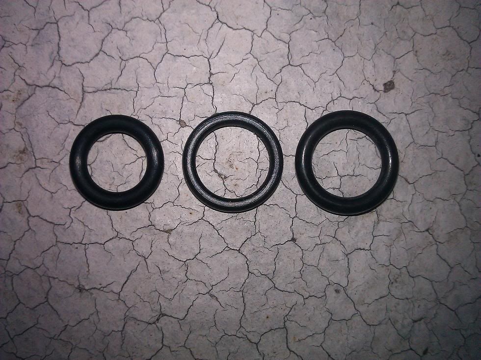

Thread revival. I'm adding information to this issue.
My Repair Process:
O-RING: (O'Reilly's P/N #110 (correct) ---- used original O-ring ---- O'Reilly's P/N #111 (INCORRECT)
NOTE: I used a drop of oil to help get the o-ring and clutch line back in.
I've read that the master cylinder piston o-rings are 0.62" diameter (up to at least 2000), and 0.75" diameter o-ring for the newer models (2005+).
I ended up using a #110 o-ring from O'Reilly's which did the trick. This is for future reference for anyone having troubles with their clutch lines, bubbles, air, soft pedal, or bleed ing.
