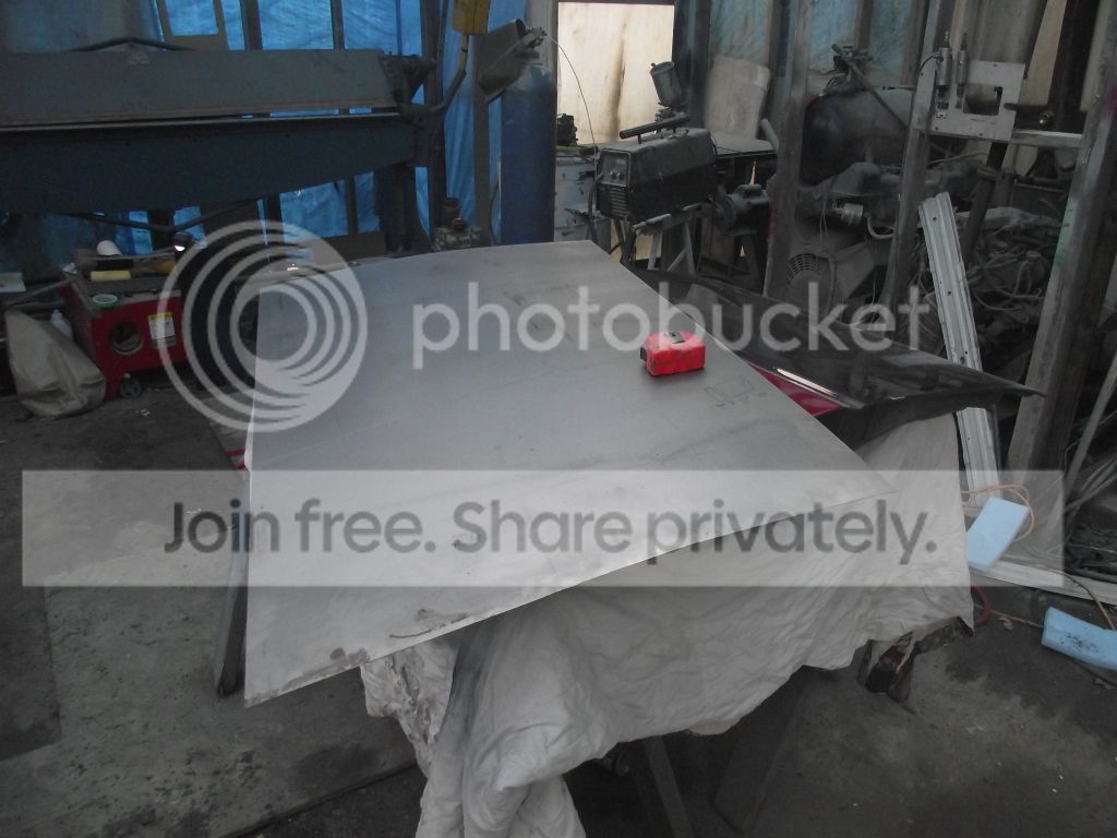

the piece of sheet metal ready for layout.a little forming and welding will be needed for this part of the project.

the top of the fill door stripped away,and the new panel formed ready to install.
now that's a bit of a stretch...
the panel fits perfectly.there'll be a weld seam in the middle of the small flat section in the middle of the door-this is the easiest area to finish it out with the least risk of distortion.
