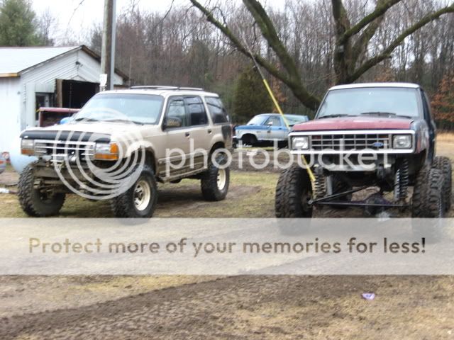

2 frames
came from 91 explorer and it was installed in my B2 build (this is the same frame as my B2 for the truggy)

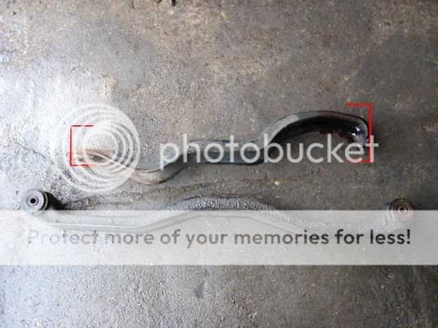

Good to hear. So you said if it does you have an 84 crossmember to swap in? Whats the difference? Do you have a pic? Was it only offered in 84 or is there a range of years?
Not Another CTOR Build
heres the 84-85 next to the 86
Oh cool. Thanks for the pic. So it goes over the exhaust rather than under it. That'd be nice.
yes, but it does not fit well over the convertors.....or a doubler do to the driveshaft location.

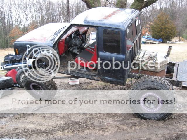

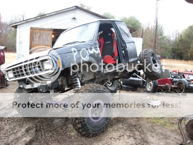

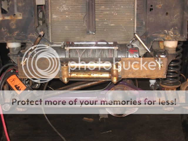

Steering installed, Front shocks installed, Started on the front bumper, and played a little and flexed it out a little with the chain fall.

Front springs def need to get broken in though. Still not happy with the overall ride height....but i will have to most likely wait till after my trip south to change that.

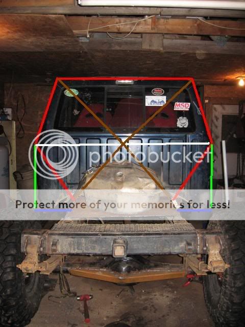

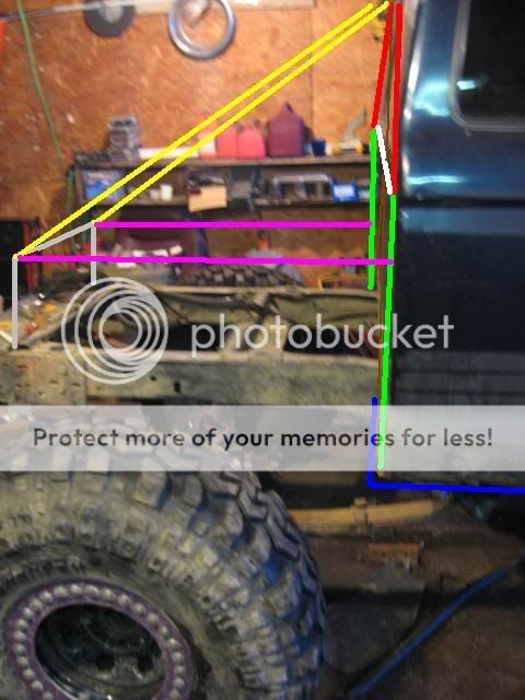

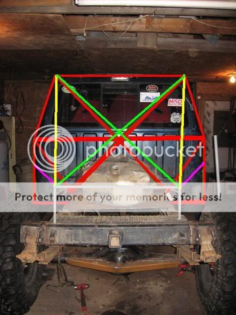

okay basically this is just the back of the cage veiw only (or "c" pillar)
each color represents a peice of pipe.

side veiw

red is exsisting c pillar

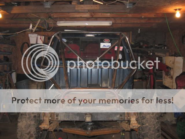

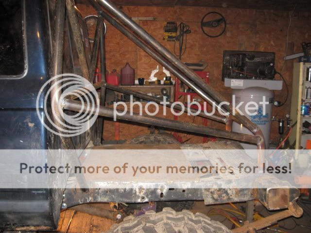

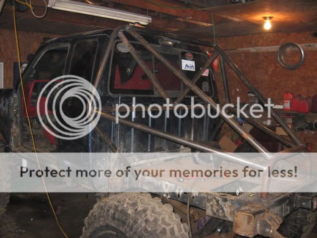

Heres the side of the rear section of cage.

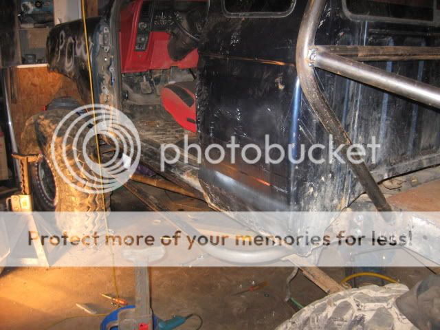

Start of the Slider

I plan to tie the cab's exo cage to the slider (reason for the slider sitting so far from the rockers

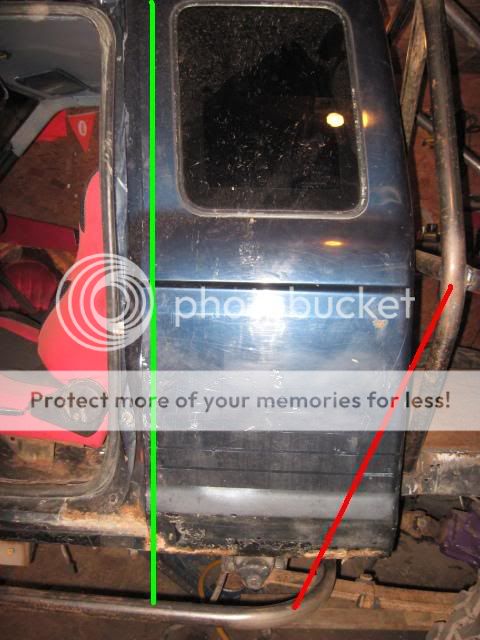

The slider didn't end up where i thought it would in the rear. One cause of the frame curved up and two cause the tire to cab clearance wouldn't allow it where i thought it would go. Heres what i think i might do at the cab corners.
