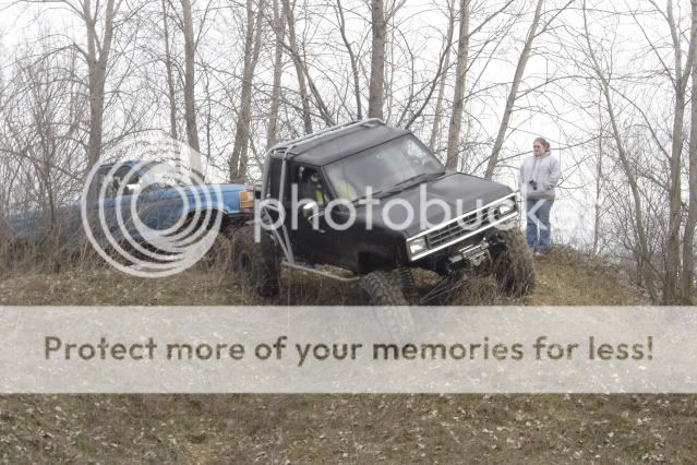

Did really well, I thought with how high it sat it was gonna feel horrible and unstable but it atually felt extremely comfortable.

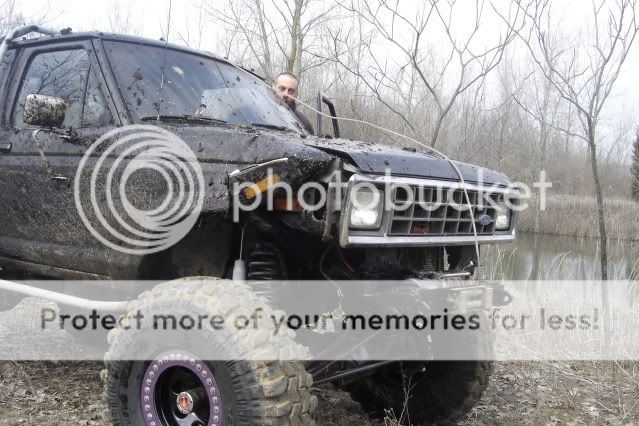

Mashed the Right Fender, and need to resecure the Left lower coil bucket (kept popping the spring out) and the starter is having issues. Also it is running hot so a new thermostat is in the works.

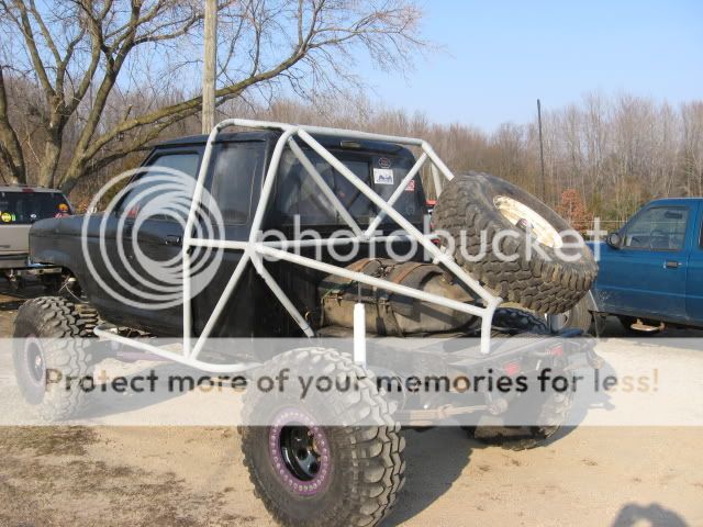

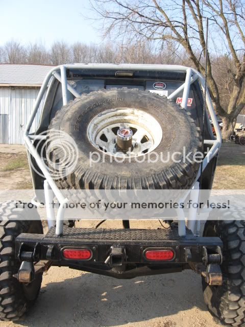

made my spare tire mount
Not Another CTOR Build
Its held to the cage by the spindle....this way i do not have to carry as many spares in the truck with me..
one spindle, hub, rotor, lockout, bearings, and a stub shaft

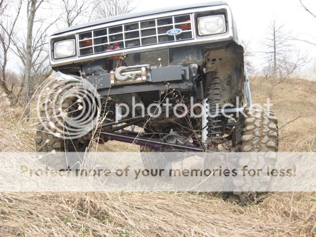

added the last of my pipe i had to the sliders for a little more support.

Yep first day about 3 hours in i blew out the cross pin in the mini-spool in the 9"......Broke it in like 4 pieces rumping on it. Thankfully about two hours before we left on Last tues i welded up another carrier i had and packed it along. About an hour i had it fixed and wheeling again. This was Thurs.
Friday i had no real problems. I had developed a PS leak at an o-ring on the line at the pump, but an occasional top off kept that problem at bay.
Saturday we were playing and i started to spit a cap, but caught it before it munched a shaft. So got a spare ujoint installed on the trail and kept on rocking. Later saturday on the way back down the mountain i sudden;y couldn't turn left. The plate i welded to my frame for the trac bar mount began tearing off the frame and was taking the frame with it. So two rachet straps and my winch cable placed just right got it held in place so i could drive down the mountian.
