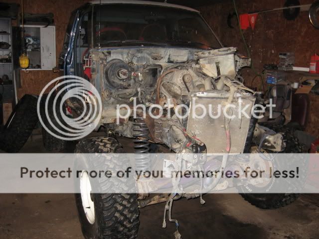

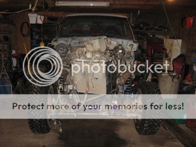

Got the radius arms on, mounts made, trac bar mount made, coil buckets attached.
Now i can start assembling the truck so it actually looks like a truck again.
Got the front clip assmebled.....

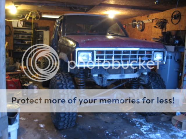

Also got the 38's on it, and relocated my rear axle and susp to gain the clearance on the cab.

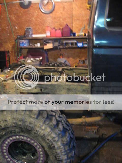

A stock B2 (its a B2 Frame) has a wheelbase of 94" I have stretched the wheelbase on my frame to 114"
Sick build. gonna flatbed or leave it bare?
some type of bed cage, need to mount the gas tank and a spare back there somewhere
because thats what i had.......The over all length of the frame is about the same as a stock b2....the only "addition" to the frame is the extra from the rear bumper sticking out. So i have 114" on a b2 frame which gives me alot better approach/departure angles.
