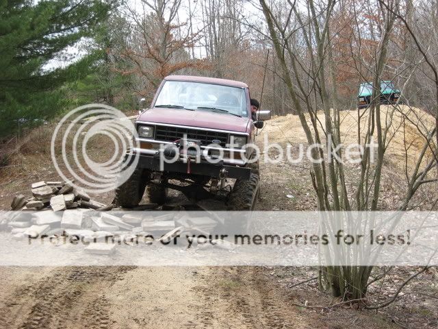

Well had a shakedown run today on some private property.....and it performed magnificently, the last place i wheeled was at this same place. And that time i broke early and broke a few different things and never really got a chance to drive the obstacles on the property. But today i did almost every obstacle and did ever one with ease except for one. Truck was awesome and the TSLs are FAWKING awesome compared to the Iroks i had. Just totally happy overall.

extremely happy with yesterdays results

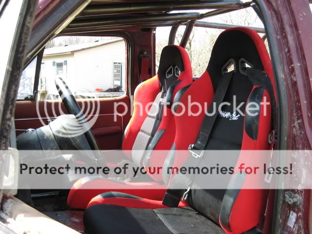

both seats mounted

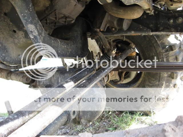

took some shots of the front susp. heres the LF at ride height

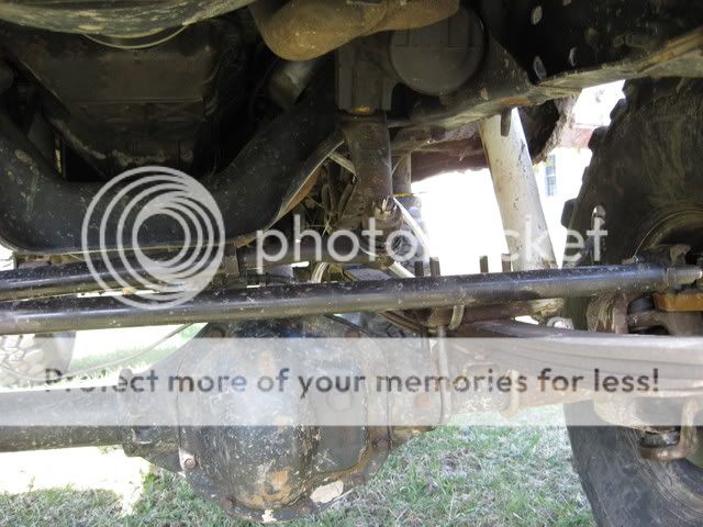

heres the Front diff at ride height, i was concerned about clearance of the diff to engine cross member
heres the diff as stuffed as i can get it in my yard,

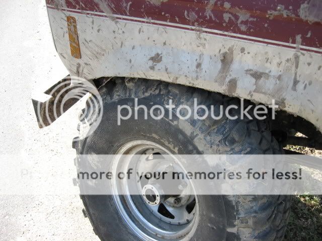

heres the fender to tire at flex, the tire just fits inside the fender without rubbing to bad

pics look good-those are 35's no? I guess you do have a decent amount of lift but I'd say the clearance looks fine with the engine crossmember.
