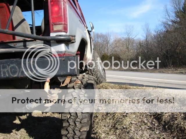

still need to trim more of the fender, the tires rubs still pretty good in the center

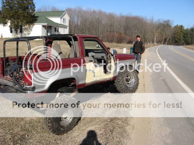

lookin great.. you happy with how the leaves are performing?
oh and half doors in the making too huh?

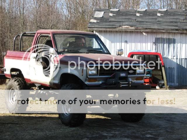

i need to mount my shocks and do something different with my pitman arm. The pitman arm hits the drag link on compression on the Left side. Springs seem fine, i might add a full length spring just to piggy back the main leaf for strength. Alot of people running the same style set-up have problems bending the main leaf.
