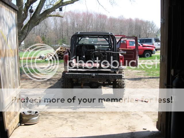

Got the cage painted and welded in some more bracing etc....Cage is down for now till after the Badlands. Got the Pass Seat mounted and the 5 point i got from General (thanks Buddy) mounted up. Also mounted my CB to the top of the cage at the cieling.

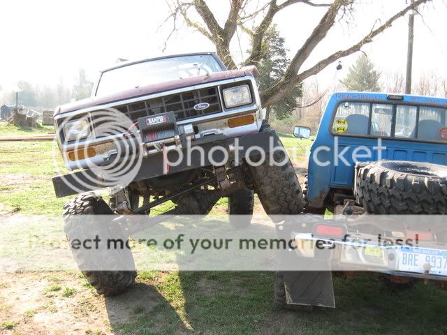

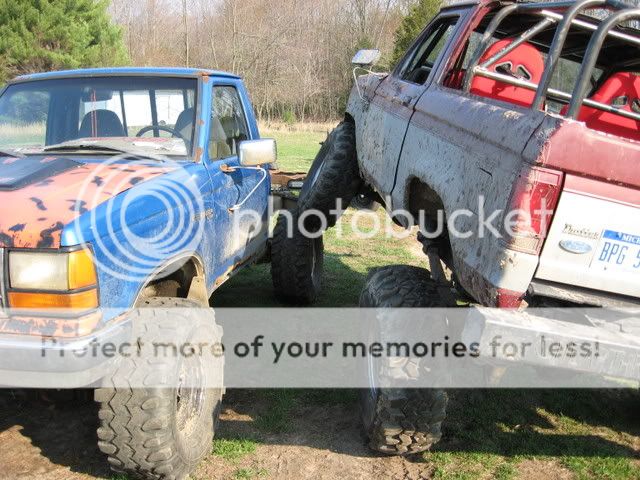

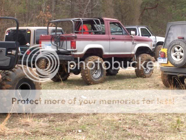

Heres a shot messing around with Holshotracers Rig

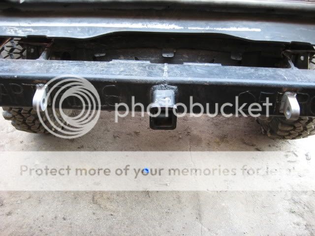

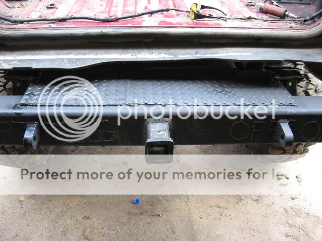

I also worked on my rear and front bumper. You can see in the above pic how wide the bumper was. I took about 5 inches off each side.
Not Another CTOR Build

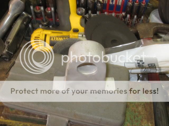

then a clubmate made me some D-Ring mounts so i got those installed

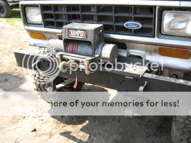

got two in the front as well
Then i had some diamond plat laying around so i added that to the bumper as well

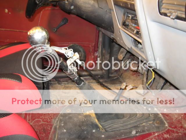

Cost me all of $15 and about 20 minutes of my time.....need to figure somethig different for the handle. The linch pin works enough for me to try it out around the yard (Fawking Awesome). I'll have to stop at TSC or Ace and find somethign better to use.
i searched the forum, and the tech library. Was suprized not to find any info on how or even pics
is this a hand throttle I'm lookin at?
