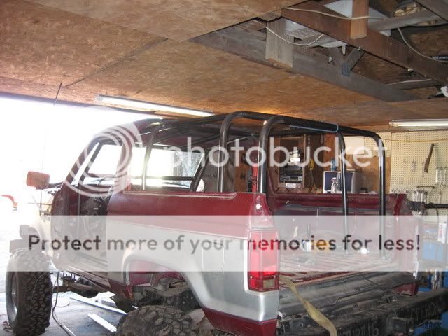

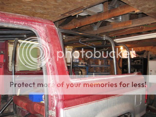

well today i got all the imterior plates drilled and bolted to the floor and wrapped up the B-Pillar and forward. So all that is done. Still have to put the harness bar and cross brace the b-pillar. But i started on the back half of the cage and got both hoops bent and a couple top bars installed but the chop saw wheel wore out so that ended my day. Heres a couple shots.

B2 is lookin good!!!!!!!!!!!

holy shit that looks good. i'm increditably envious of your access to a tube bender. i want to add to my cage and bring it forward aswell. but its kinda hard when all i got is some thin square tubing and a 110 wire feed. haha.
looking good all the way around.
WOW that is crazy cool
How much did all this cost you?
lookin good. do you plan to put a soft top on it or just leave it open?
i will have a soft top made for it.....
I have $200 into pipe, and the chop saw is borrowed (but i am buying a new disc for it to day $8) I had to exchange my welding gas so i suppose another $40 their. And today i need to get another spool of wire for the welder $25.
having a cage that will save your life in a rollover...priceless

i got a little more done today....
i bent and welded up the back hoop, i also got the seat frames made for the front seats to attach to the cage seperate of the body. That seat frame was a PITA to deal with cause of the hump and trying to get the seat height right. Later i will have actual buckets but for now i'll deal with the explorer seats. I had to buy a new spool of wire, ran out lol. But i did drive a 100 miles today to purchase something i have desperatly needed for several years and now i will never have to borrow one again............
