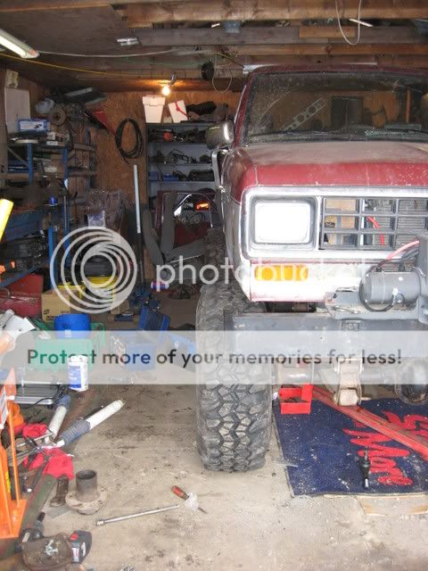

just a shot from the front

looks like the front of my yj

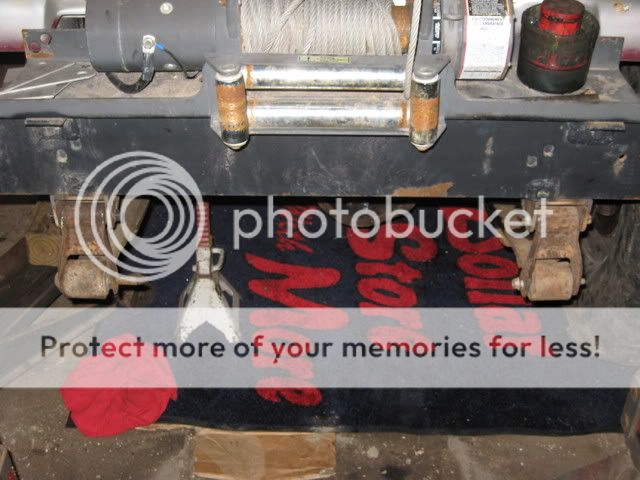

got the tie rods sitting on the arms. Had to measure the length of the tubes to buy and thread.
Not Another CTOR Build
width turned out almost dead on with the 8.8 and adapters.

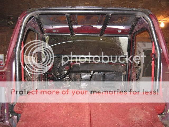

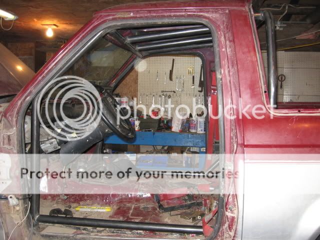

okay having never built a cage nor have helped with building a cage and using a harbor freight bender i have to admit building a cage SUCKS.......oh and not having an actual tube notcher doesn't help either.....
heres my progress thus far
got everything tacked all good and nice then start welding and the stupid things warps and becomes a PITA.....pretty much all my plans backfired. Go at it again tomorrow and hopefully get it close to finished up.
FLAME ON :buttkick:
As long as you have the cage anchored well to the frame and your welds are decent, I think that should hold. I can see how it could be a bitch to implement a cage.

I think the cage looks great, especially using the HF bender. keep up the good work and I'm sure you'll find a way to make it turn out the way you plan.
i spent quite a bit of time playing with the bender useing used pipe to get to a point to where i could make the bends with no kinks and no dimples in the pipe. Once i got the hang of it i went and bought the new stuff and started the cage. I was happy with the bends, i don't have a single dimple or kink in any of the pipes.:3gears:
I used sch40 when I made my doors and didn't have problems with kinking, it just flattened out the corners. whats your secret? did you fill the pipe before bending?
