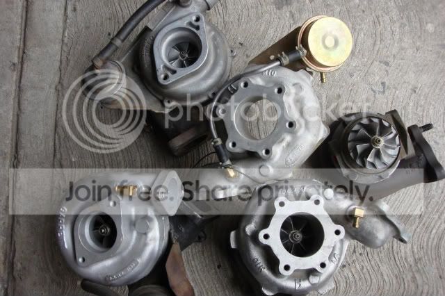

AND I DONT KNOW WHY I LIKE MORE THE BRAND GARRETT
THIS IS MY JUNK TURBOS
