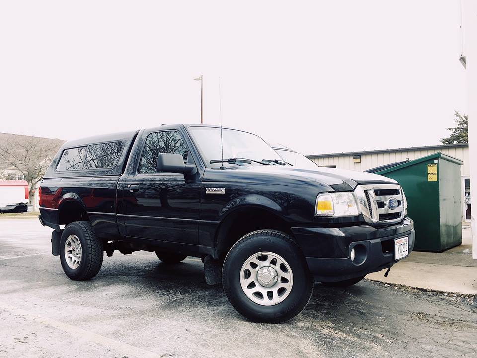

D'oh, turns out that's exactly what it was. Problem solved. I read a bunch of posts about people having problems with the multifunction switch in the steering column and sort of assumed it had something to do with that, but I'm glad I didn't have to dig too far.
Shameless lift pic included for good measure.
