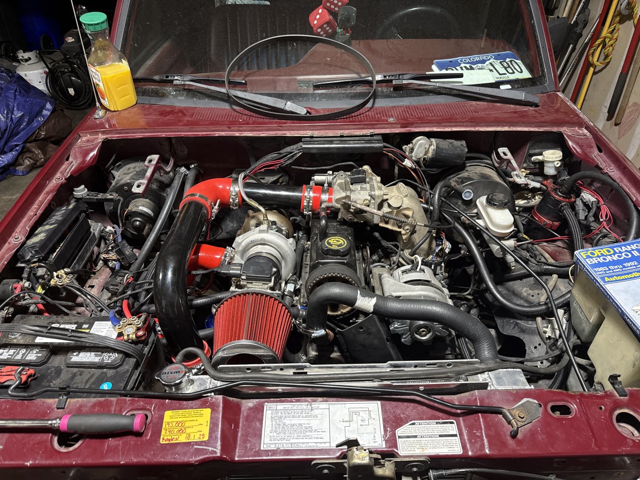

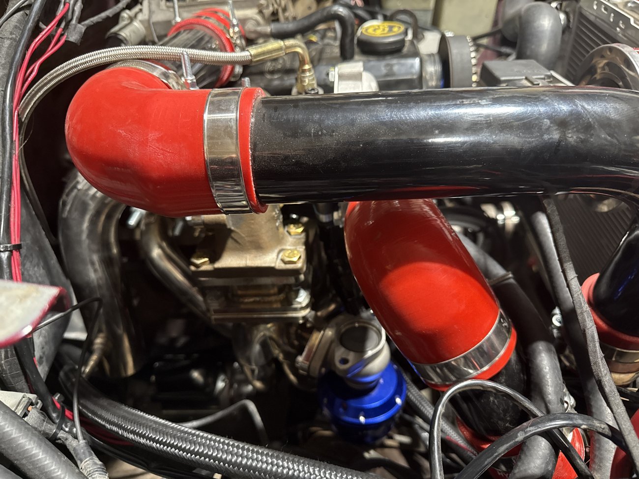

My 2.3 will not start period. For some context piston rings were in poor shape as I was burning almost a quart of oil in a few days (it was running on hopes and dreams) finally decided to rebuild the engine and add a turbo kit intended for the thunderbird and ranger since its almost the same engine minus the emissions stuff and the dual ignition system. Now it’s just a tiny .63m turbo and has all the necessary oil lines and everything to run how it should, that’s not the problem. I originally had an issue with no spark and found out I washed the rings out with gas rebuilt the engine a second time whilst fixing the cps hub since I found it was damaged an the cps wasn’t reading properly. Now for all the stuff I deleted was a majority of the vacuum lines the ones going to the egr valve and the one going to the intake from the vacuum solenoid deleted the egr valve and installed a block plate and an emulator to plug into the harness. I deleted it simply because there was no where to install it to the exhaust manifold. I also deleted the pcv system and installed an oil catch can. I have compression, spark, fuel and air I just can’t figure out why it won’t even give me anything. Just need some help pointed in the right direction, sorry for the essay.

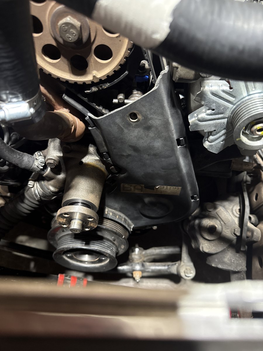

I do smell gas on the plugs so it’s getting to the cylinder I’m gonna go buy a compression text kit from somewhere, I got one from harbor freight but it didn’t have the correct size for the threads in the kit. I also want to double check timing and everything do you know of any sources other than the book to double check timing mark place ment. Is there supposed to be a specific point that the oil pump pully is supposed to be placed because it only has the diamond on the pully but nothing indicating on the back timing cover? other places say that the timing cover is supposed to have diamonds mine doesn’t it just has a notch for the crank pully and the cam pully no other marks. As soon as I get home I’ll grab some pics of how I have the timing to kinda see if I messed it up.

For timing you can ignore the oil pump pulley on a '90, it does nothing important to be timed for, most of the stuff online is based on having a distributor or the '95 plus that has a cam sensor... On a '90 there's a mark that you can see in the access hole on the outer cover and on the back of the pulley there's a notch on the top that matches up with a notch on the top of the inner timing cover, the crank pulley if you have the balancer off has the keyway pointing up and there's a notch or dot that lines up with a mark on the inner timing cover.

I'll ponder things and stare at the pictures and see if I think of something dumb, it's always something dumb...

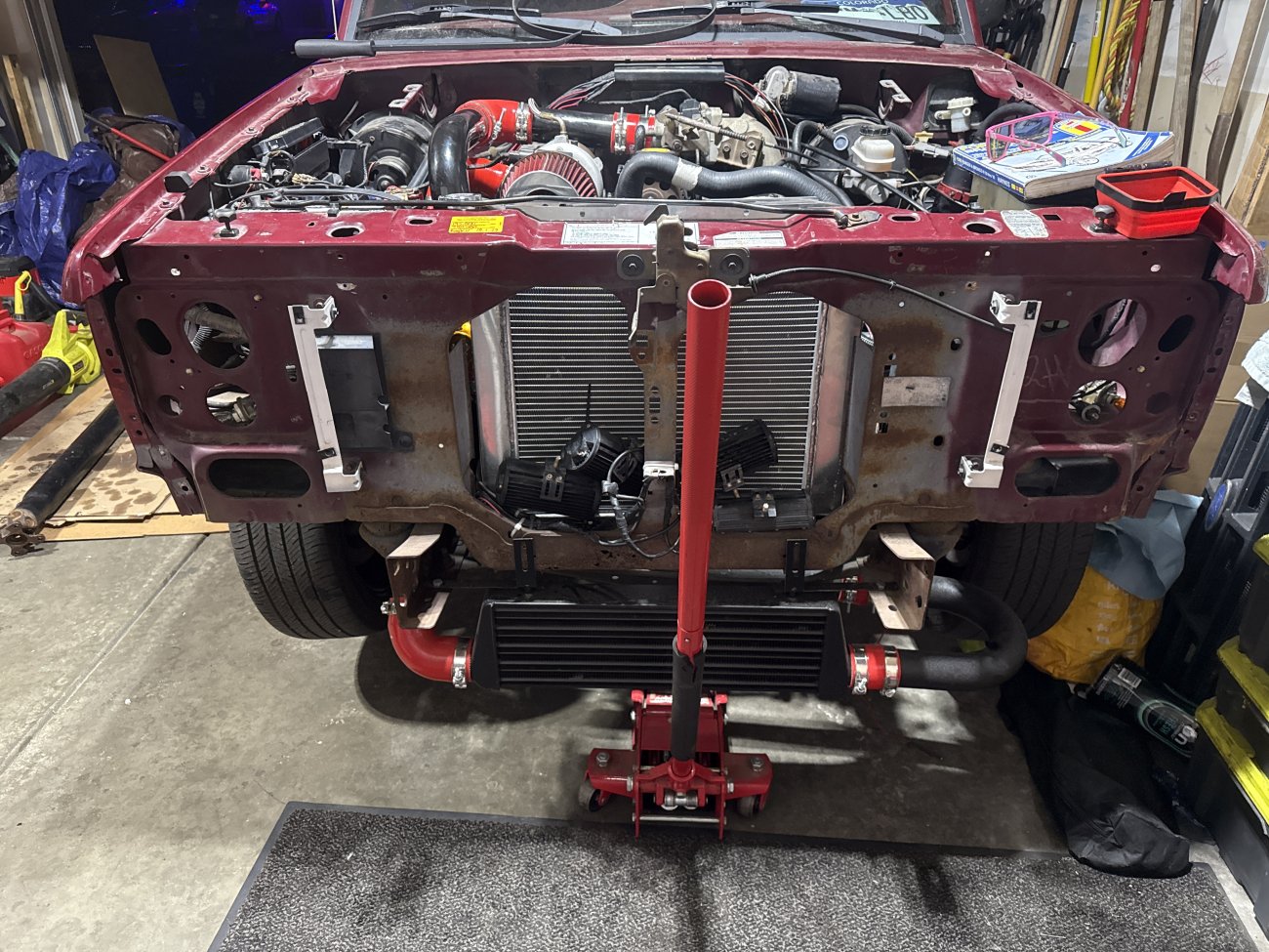

Intecooler is mounted at the front underneath the core support between the frame

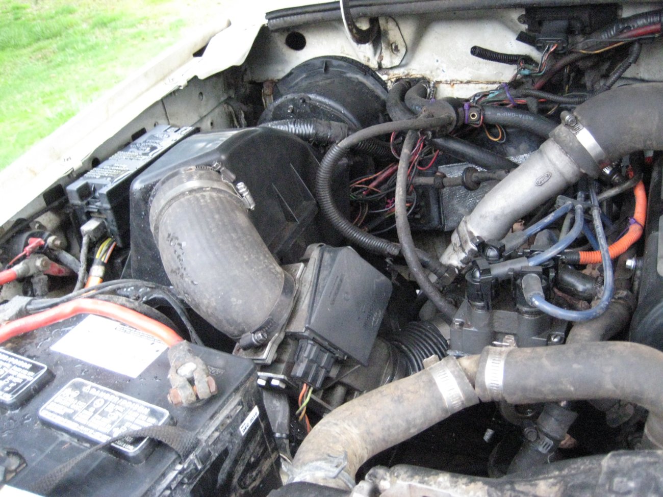

I figured, this is pretty much the setup I have now:
No start turbocharged 2.3 Ranger
Different turbo now but not much changed... I never got as far as putting in an intercooloer obviously, I have a stock thunderbird unit but no airflow to support it, thought of an air to air by the radiator but that's a dangerous area in what I do, thought of an air to water then a radiator in a bedside just haven't gotten there... For my uses it works for now...
