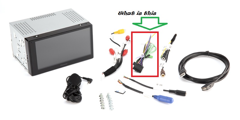

There are no speaker wires. Just a harness that plugs in with RCA outputs.

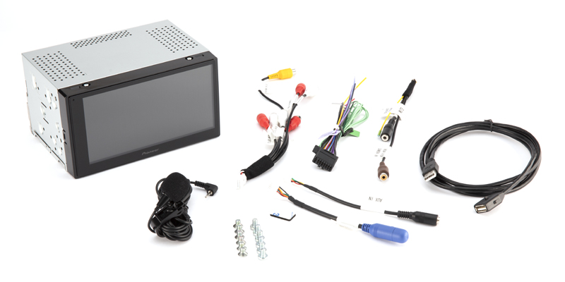

Here's what's in the box:
73360
The harness in the top middle is power connections. There's no speaker connections on it. The cord to the left has the RCA outputs. No speaker outputs.
I need to look again. I think they're there. The directions lead me to believe it's a separate harness.

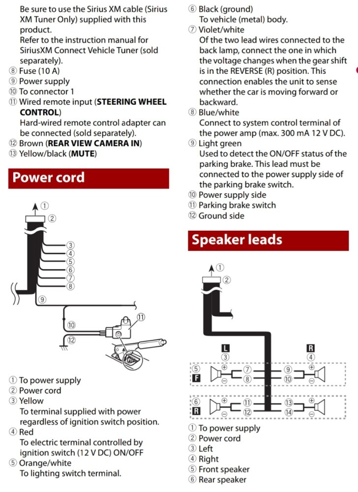

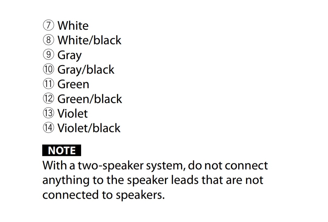

Well looking at the the provided picture and the wiring diagram your power connector has way more wires than just the Full time power, Switched power and Ground needed to provide power. The last pic provided shows the wiring for the speaker color codes. The power connector has your speaker wires, at least according to the pics and diagram provided.
If this connector is different than the pic provided can we get a pic of the connector and wires they provided you?
If you look at the speaker leads section you will see a group of wires coming off the connector with a squiggly line and dead ending, the same with power cord diagram. This is the separation of power and speaker wires on the same connector.
A little confusing I know but it is the same connector,

Pioneer has used the same connector for years. The even used that connector on the pre-amp only head units. (With no speaker wires installed.)
It is possible that they shipped a pre-amp only harness. It would have the same 16 pin connector, but it would have no speaker wires and 8 empty spots.
Post a pic of the power connector you got.
