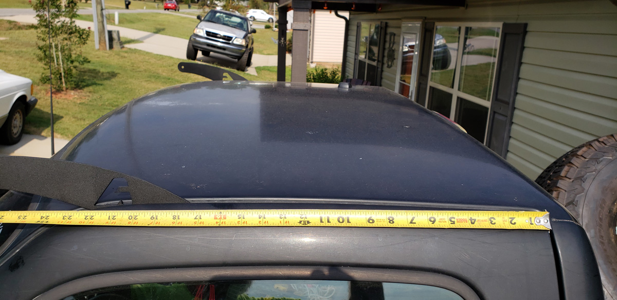

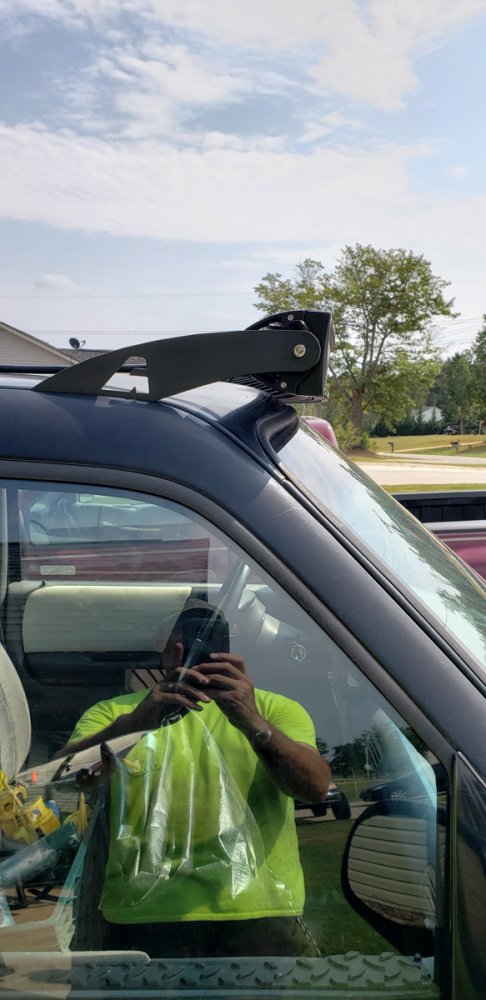

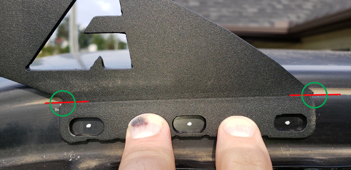

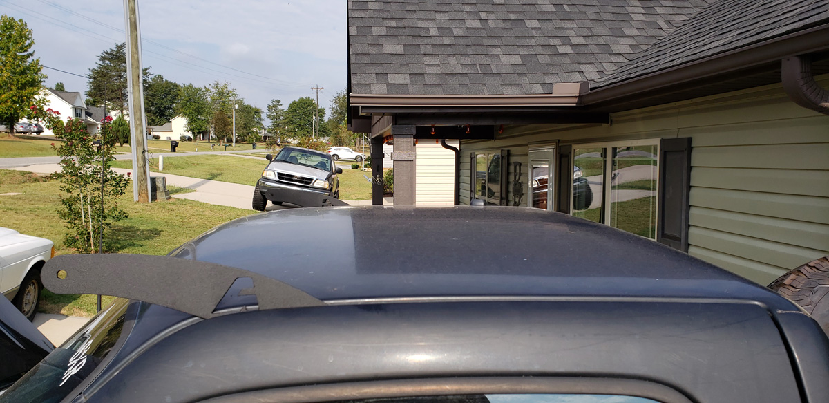

Decide where the brackets belong. The Apoc Brackets mount to the side of your roof, behind the weatherstripping for the door. This makes a very clean installation that looks great in my opinion. The next few pictures show the bracket stuffed in place and held by the weatherstripping until I could measure and finalize the placement. You can hook a tape measure to the rear top corner of the door as a reference point. I used the little point in the bottom of the Apoc logo as a reference on the bracket and made a mark at this point on the roof so I could find the position after opening the door and removing the weatherstripping. For a Gen3 body, 20 ¾” from the rear edge of the door worked out well. Any further back and the middle of the light bar would have hit the roof above the windshield. Too much further forward and you will run into the curve where the A-pillar meets the roof. For vertical alignment, the Apoc bracket has a notch at the front and rear edges that I aligned with the first bend in the roof’s sheet metal. I tried to point that out in the next photo.
