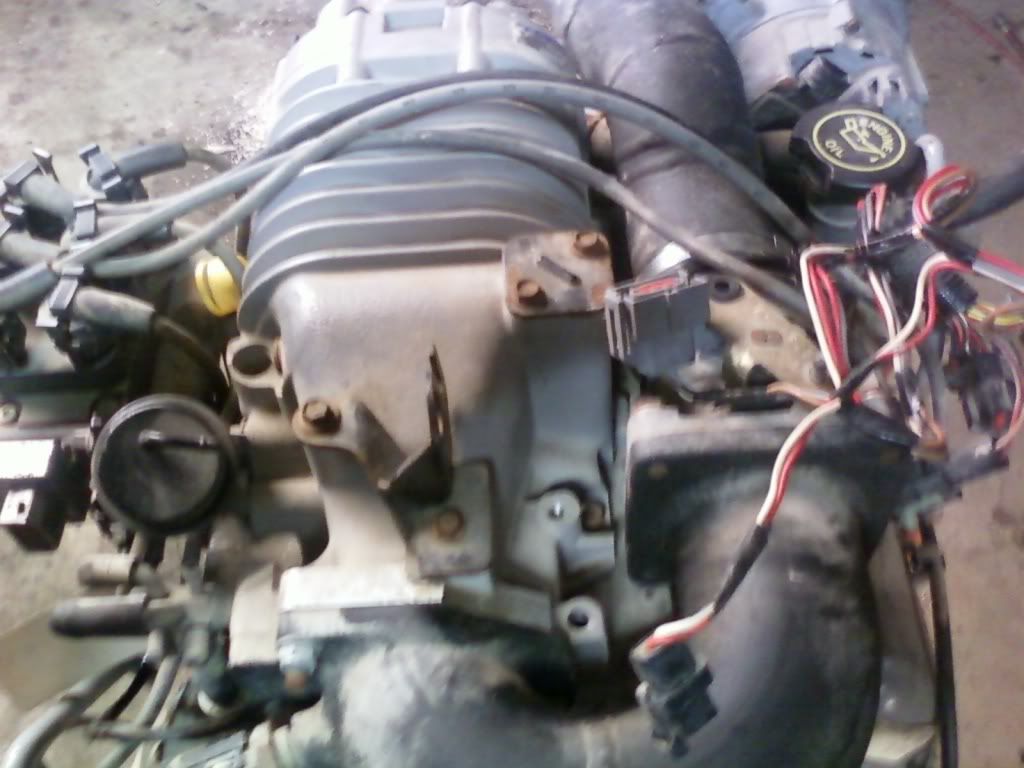

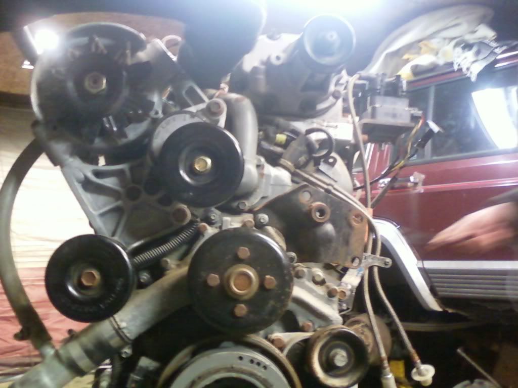

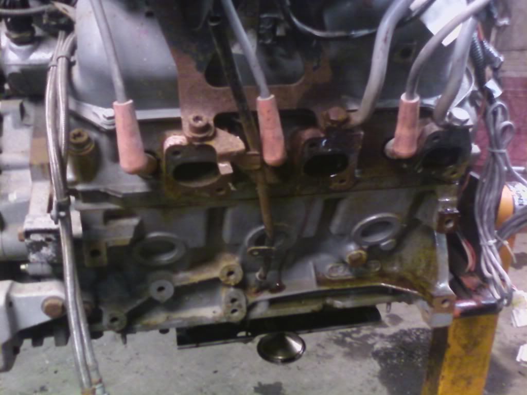

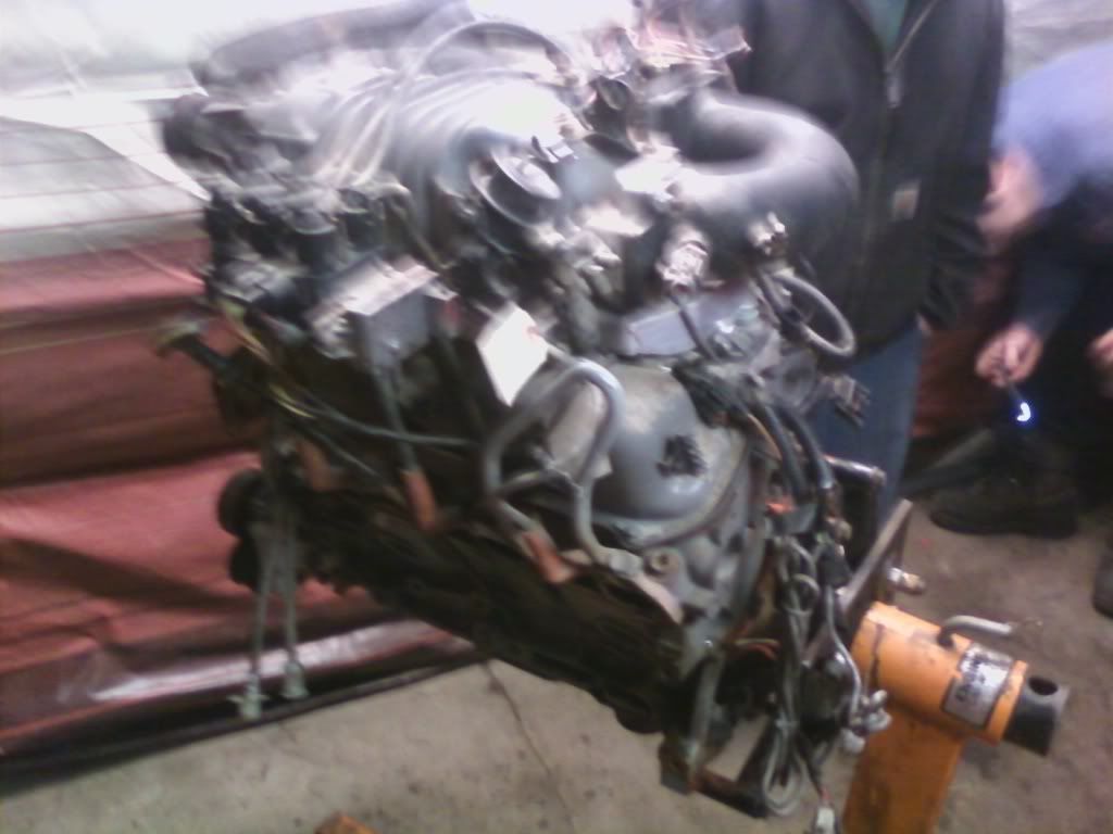

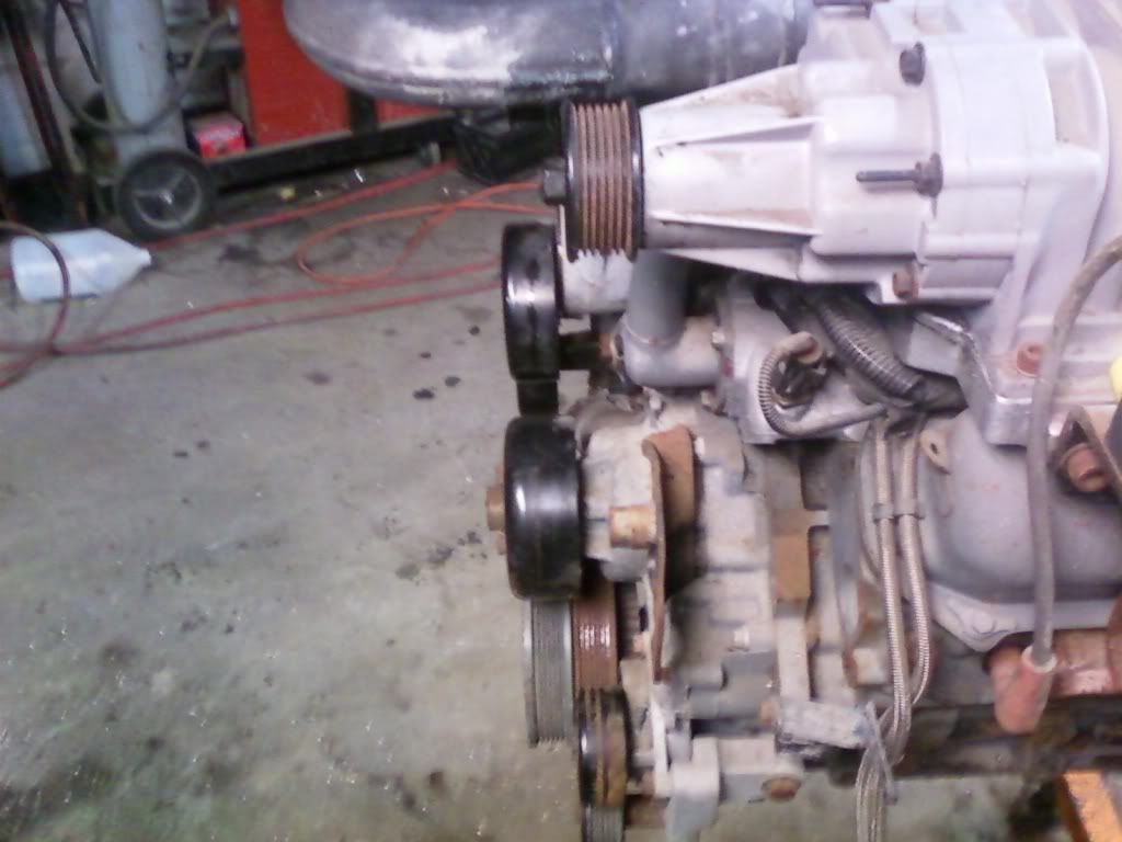

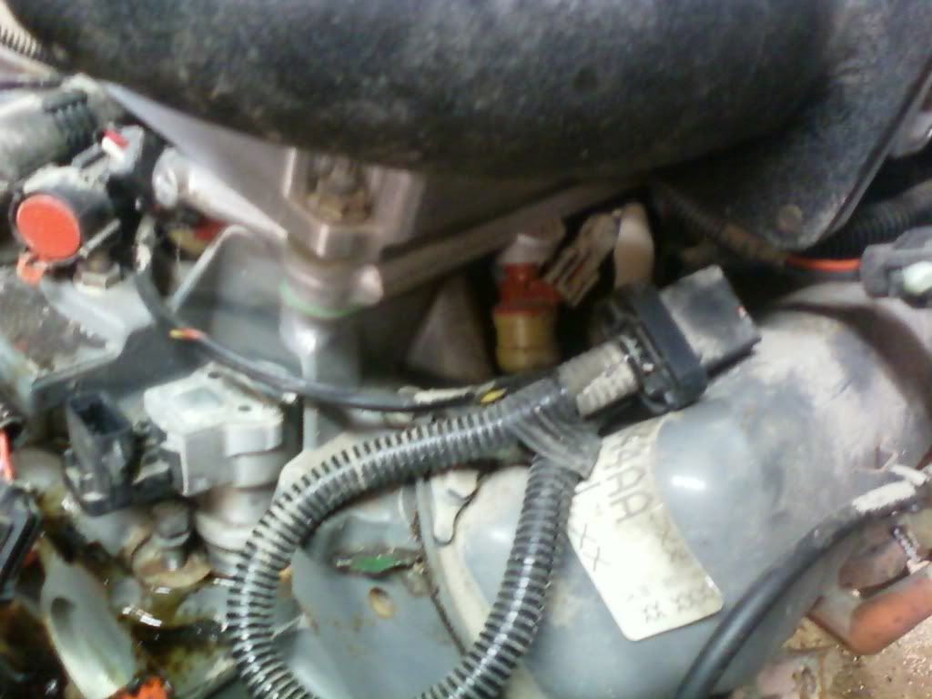

Finally did get some crappy cell-phone pictures. Maybe I'll pony up for a real camera before too long. Last picture is of the odd long leads on the back of the engine.
<a href="http://s909.photobucket.com/albums/ac295/monsterchuck_photos/?action=view&current=SSPX0167.jpg" target="_blank"><img src="http://i909.photobucket.com/albums/ac295/monsterchuck_photos/SSPX0167.jpg" border="0" alt="Photobucket"></a>
<a href="http://s909.photobucket.com/albums/ac295/monsterchuck_photos/?action=view&current=SSPX0168.jpg" target="_blank"><img src="http://i909.photobucket.com/albums/ac295/monsterchuck_photos/SSPX0168.jpg" border="0" alt="Photobucket"></a>
<a href="http://s909.photobucket.com/albums/ac295/monsterchuck_photos/?action=view&current=SSPX0172.jpg" target="_blank"><img src="http://i909.photobucket.com/albums/ac295/monsterchuck_photos/SSPX0172.jpg" border="0" alt="Photobucket"></a>
<a href="http://s909.photobucket.com/albums/ac295/monsterchuck_photos/?action=view&current=SSPX0174.jpg" target="_blank"><img src="http://i909.photobucket.com/albums/ac295/monsterchuck_photos/SSPX0174.jpg" border="0" alt="Photobucket"></a>
EDIT: How do I make these into links? I just made a photobucket account, and copied the URL it gave me after clicking share.

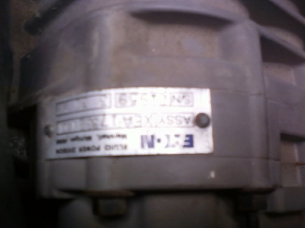

Jeez, you guys are going faster than I can keep up. Yes Angie, the blower is an M-62 that was used on the GM series 1 3800 supercharged. I happen to have another one and compared it, it is identical. It may turn out to be a little small, depending on how much boost it'll take. I'll probably go less than 10 psi, probably 6-8, so it should be alright.
You'd like that, wouldn't you?:) I have the oil pan off it, you can see in a few pictures. This thing is brand new on the inside. It's been run before, but not very much. There's no carbon buildup, nothing. Just a little dirty oil in the bottom of the pan. Everything else is just clean except carbon on the top of the pistons. Speaking of pistons, I used a bore scope to read the numbers inside the pistons, and I need to know if they are stock or not. They look very similar to the ones that should be in it according to the tech library, but I need to be sure. I will check at work tomorrow, but I don't really expect an accurate answer. Does anyone know a good way to identify them without removing them? The numbers I found are M279A, 100S126, and 100V28. They are Mahle pistons with a Ford logo cast into them, so they are likely stock.
Alright, here's a little update on my history check for this unit: Took one of the tags in with me to work today while trying to identify pistons(which I'm just going to assume are stock-ers). Handed it to one of the parts guy's for him to look at. There is a number on the bottom of the tag, which I though was just a cataloging number, didn't think much of it. He sees it, and says "I wonder if that's the last eight digits of a VIN". He plugged it into his computer, and sure enough, 1992 Explorer XLT 4-door, 4.0, auto, electronic shift-on-the-fly 4x4, 3.73 axle gears, limited slip rear end, ect, ect. I asked if he could give me the whole VIN, and sure enough, I've got it wrote down right here. Unfortunatly, being a 1992, I can't pull up anything on OASIS, our sales department says they have no way of checking anything that old, and parts department can't tell me anything else origin-wise. I've looked for VIN reporting services online, but I don't really want to pay $30-$40 for it if I don't really know if it will tell me what I need to know. I'd like to know who sold it, when it was delivered, who bought it, ect. Does anyone know of anything else I can use? Or would a carfax be worth the money?
