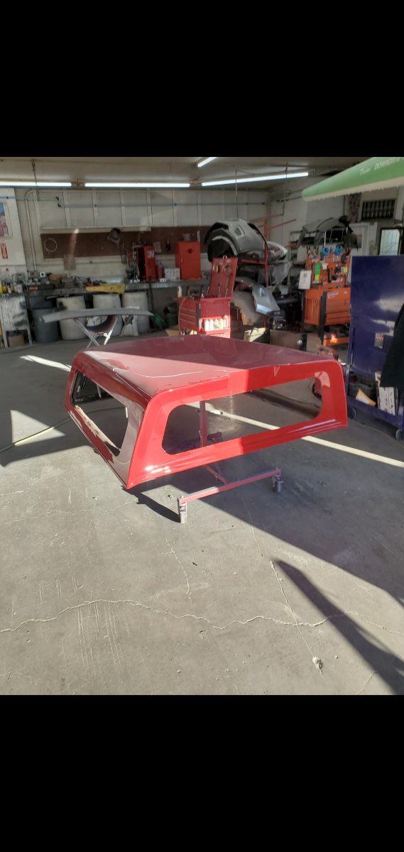

Previous owner had a pretty beat up white metal shell on the back. I wanted a nicer shell you could move stuff around and have it secured and out of the elements. I ended up selling the white top for $100 bucks to another ranger guy and scoring an old fiberglass Raider shell from a junkyard ranger for $100 bucks. Completely rebuilt and repainted it to match the same color of the ranger.

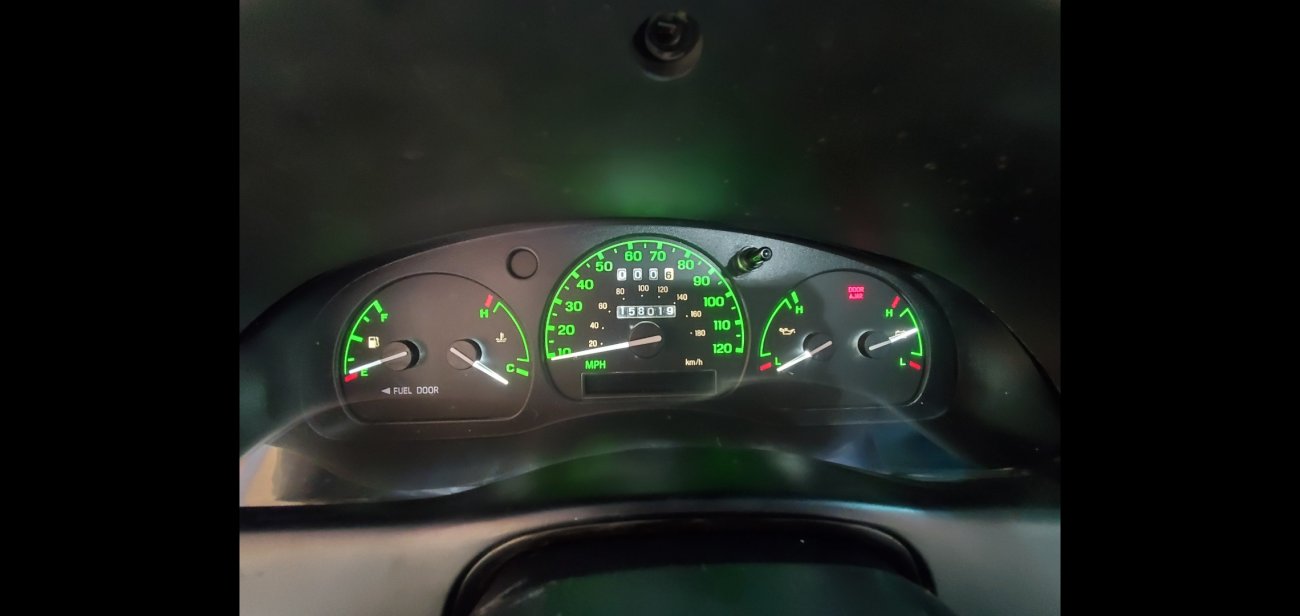

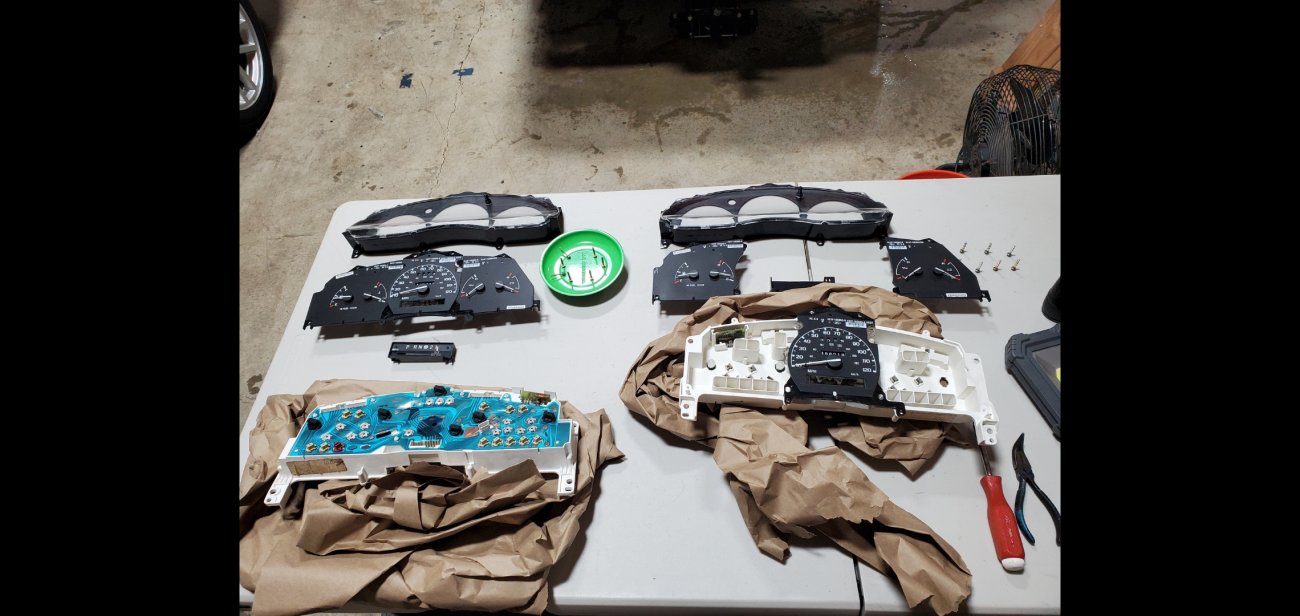

Not too long after that I started noticing a lot of electrical gremlins. I assumed it had to do with the truck sitting for as long as it had. Issues with the wipers, blinkers, ABS "buzzing" sounds coming and going until one day the entire instrument cluster went out. No speedo, odometer, warning lights, etc. Tore it apart and found a ton of corrosion on the plugs going into the cluster. Ended up going back to junkyards and pulling out a ton of instrument clusters until I had made my own fully functioning cluster again with almost identical mileage (truck had a little over 156k and new odometer had 158k). Since it was apart I really tore into it and cleaned out all the connections, gently filed off any corrosion I found, and LED swapped lights out. Works great and looks really nice as well. For the other electrical issues the ABS buzzing self healed the more I drove it (no idea how / why, maybe the cleaning helped?) and for the wipers I just twisted the wiper speed knob a bunch and broke up a lot of corrosion inside the knob and now they work fine. Still trying to figure this out but it looks like when the truck was sitting for all those years someone may have left the rear window open because there was a lot of crusty corrosion on many of the internal connectors. Even the back of the OEM radio was looked like it came out of the titanic and no longer worked. Did a lot of cleaning up electrical plugs when I had the dash mostly apart.

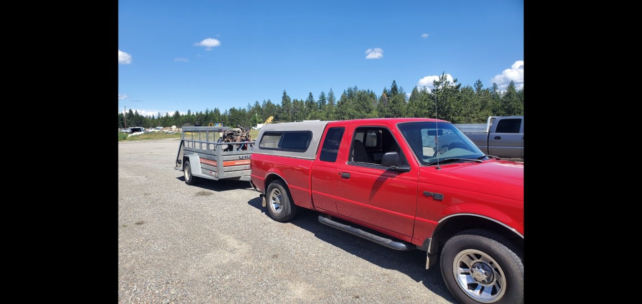

After that installed a pillar pod with an autometer tach, and used it as my "dump run / service truck" to pick up a total of three small block ford V8s, tons of axles, and a lot of other junkyard ford parts for my other projects. Truck really grew on me from this point on.
