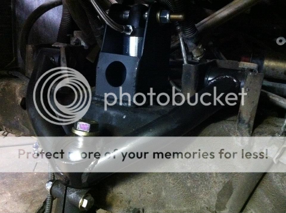

heres mine with the steel plate...
How do you figure out how high to put the hole off top of frame?
depends on the shocks you get. when i did mine, i bolted them to the lower arm with no spring in there, compressed them all but 1/4" and then measured how far out the top of the frame they poked. the mid travel kit only uses like 6" of shock stroke so you won't over extend the shock.

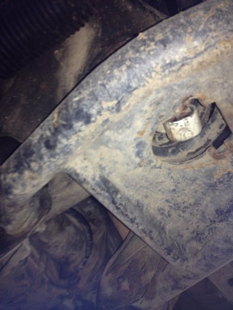

Went out to pismo and broke my drivers side shock mount on the lower control arm. My BTF kit should be here next week tho.. Fingers crossed.

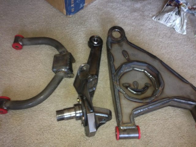

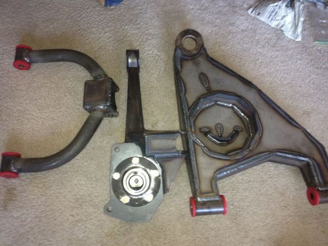

Finally got the first shipment of my BTF kit in today! Pretty pumped, this kit is a beast lol

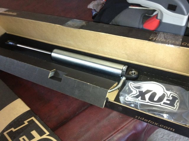

Next week I should be getting my fox shocks rotors and brake lines and I'll be ready to get it on
Got my shocks in! Dropped the control arms and spindles off at the powder coating shop. Hopefully I'll have everything on next week.
