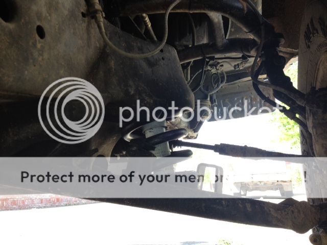

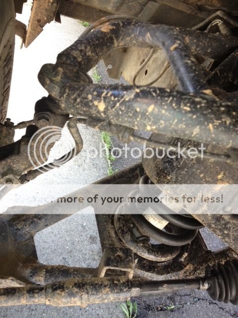

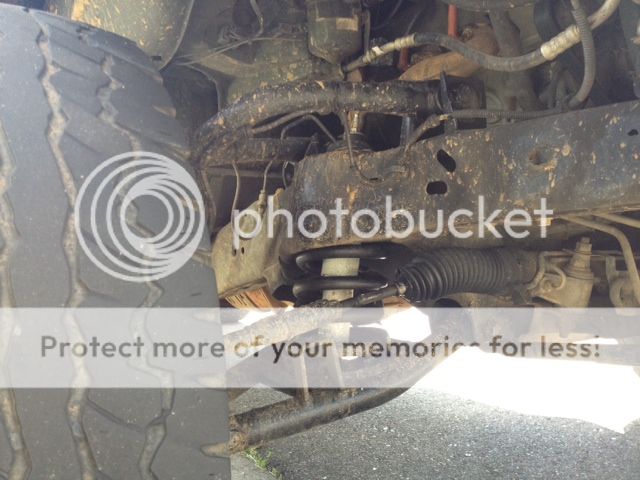

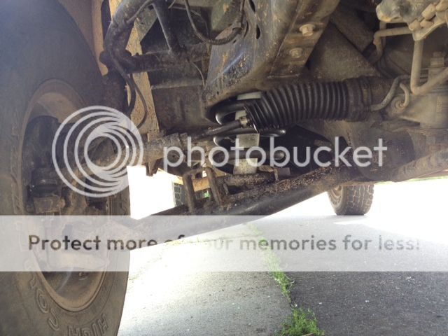

heres some pics of the front, srry its all muddy i havent had a chance to wash it lol.

ok i see a couple things i would change, personally i dont like the balljoint uppers, but they will work if you wanna keep them and keep it simple. and i would get a fabtech 3 inch lift spindle, it looks like you have the stock spindles in there haha, and you would get better clearance with a lift spindle.
and can you get a picture of the top of the frame rail, like an above picture of the suspension, cause i cant tell if you have the 2.0 upgrade on there or not, but i doubt it cause thats just a cheap shock in there. its a lot better start on the suspension than what i had to work with on my truck haha
Edit: nevermind you dont needa get a pic of the top of the frame rail, i saw that you have a stock shock in the stock location... this is what the 2.0 upgrade looks like:
as you can see the fox resi shock now goes thru the frame rail and has a custom shock hoop holding it in. if you wanna know anything about the setup in the picture jus ask me cause its my truck.

awesome, that looks legit. ok so a couple questions. looking at mine its got a round receiver for the top of the shock, did you just cut that out of the way and im guessing you fabed that custom shock hoop?
i saw the spindles on your build thread so i can def see why you like yours more. I feel like my whole upper conrol arm looks sketch compared to yours.

i actually took my truck into a fab shop to do the upgrade cause of lack of tools, but i was there whole process. and yea you jus cut that "round recievier" thingy off and build up either some tube or plate (like mine) shock hoops. like i said fabtech lift spindles are the way to go cause their beefier and i think you will like the look of the truck better anyways. and the control arms arnt too bad on your truck but it wouldnt hurt to go for some monoball uppers like what i have, but the only problem is the usually cost between $500-$1,000 depending on the fab shop and if you get discounts and such (i got mine for $500 with a ton of discounts from a fab shop in san diego.
i think your setup with lift spindles, the 2.0 upgrade and maybe new upper arms your setup should pull between 12 and 14 inches of travel. oh and i also recommend getting limit straps too.
