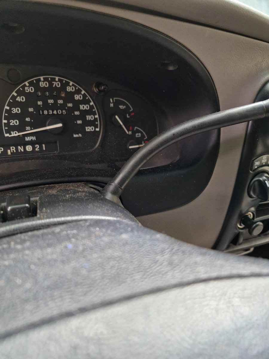

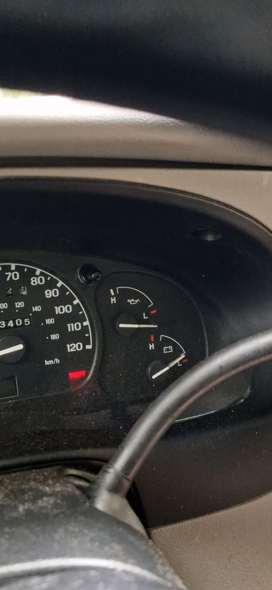

New motor now oil guage problem. Does anyone have a solution??
  • New motor now oil guage proplem
Is the wire connected to the pressure switch?
Rear end of the block, high up on the passenger side. Very difficult to get your hands on it. Single wire slips over a brass stud.
Its happened to others with this cluster, no idea how it happens. Others thru the years have taken a small magnet to reposition the gauge or others have taken the dash apart to spin the gauge back around. Once that has been done the gauge has been accurate. With it being positioned under that needle it keeps it from moving up when engine is started.
Sounds like they have no upper stop and can just bounce past 100% without power. Wild...
