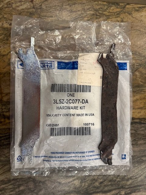

I had a brake issue, replaced some lines, and other parts, but one of the parking brake struts (links) of the rear brakes is damaged. The part number is 3L5Z-2C077-DA, but it is discontinued, and I can't find it anywhere. I can perhaps salvage mine, by bending and weld repair, or make a new one, but that is a real pain.
Does anyone have an idea where to find this? It can't be that rare among late model Ranger people.

It's one of the many parts they have decided not to make anymore. I see Dorman has stepped up and make this link, but it is for a 2003 model and older. It doesn't have the offset in it like yours has. It's #21135
Not yet. I have had poor luck in the past, even though I know the owner of the dealer pretty well. I’ll try it tomorrow. If I understood the geometry better, I’d just modify a Doorman one. That one is for 9” brakes. Mine are 10”
Are the ends with the slots worn out? I guess you could cut the ends of the dorman and weld them onto your original if that was the problem. It is just for the parking brake, so there is some peace of mind anything you fabricate will not affect the regular brakes.

The ends are worn and bent. I was thinking of trying to bend them and weld repair/grind. Your Dorman idea is good! Thanks.
Could definitely cut these out easily with a waterjet. Bandsaw would be more of a pain, but would work too.

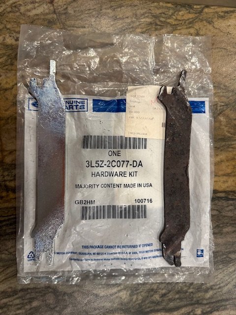

After all kinds of searching, and many calls to several dealerships, I got perhaps the last one in the US from SAMES MCALLEN Ford in MCALLEN, TX.
One of the dealers told me he gets a call every other week for one of these, because it shows up in their inventory and he can't remove it.
I may cut a few out of some steel plate, if others need them. Thanks for all the help!
