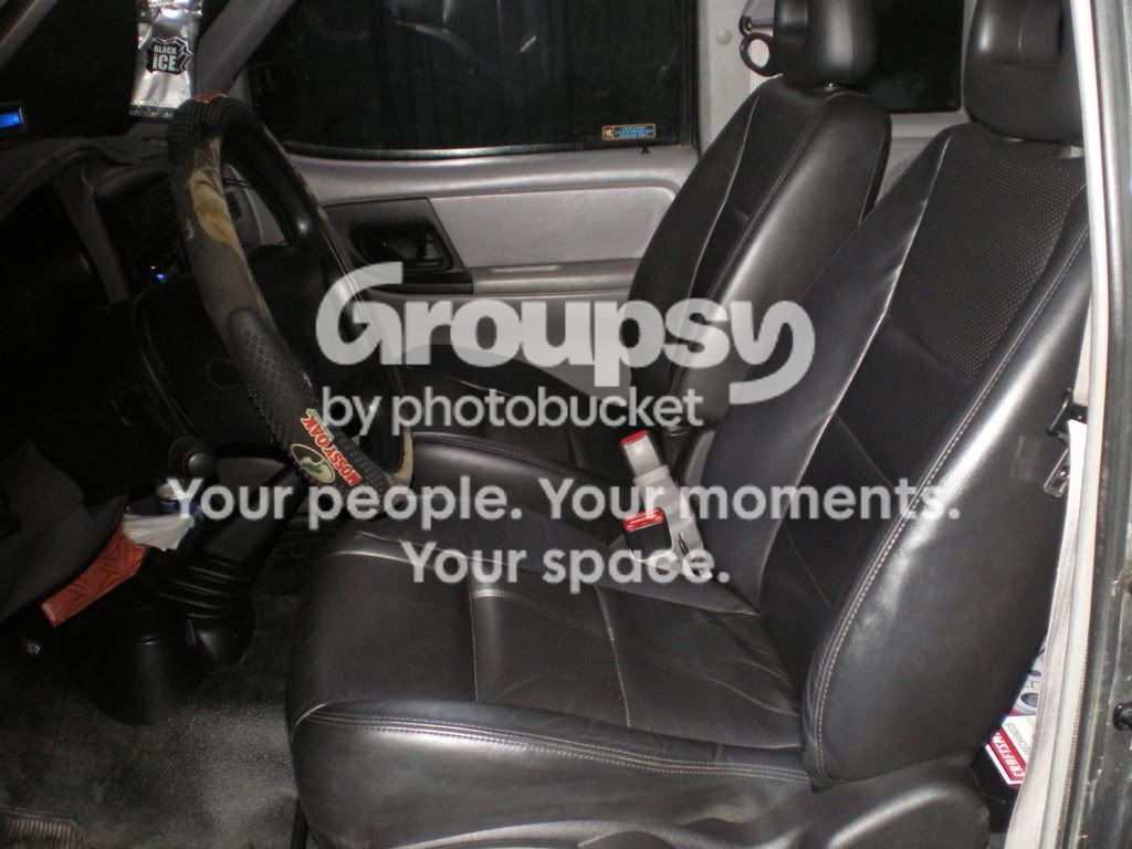

put in 2005 saturn ion leather seats all manual with driver height adjustment, and a dash mat, and a xm radio that my dad found on the side of the road in the box with every thing but the casset to audio jack adapter which i didnt need anyway. well i plugged it in and i works and i am getting a signal (i have been for a year and 1/2.....i had it in my old truck and was just waiting for a dash mat so i could velcro it down) well tell me what u think

those seats are sick..:drool: how much fab work did you have in getting them in?...:icon_cheers: nice job looks great..
the slider rails are 4 inches wider so i cut the mounts of the ranger seats and off the saturn seats and then took 2 peices of 2 inch flat stock and welded the ranger mounts to the stock and the stock to the saturn rails. i give it a 3 out of 10 for the trial and error i had to do btw the mount rivets r defiantly the hardest part

tracks off a split bench from a 94 ranger, bolted right up.
now those are some nice looking seats, but they do make the interior look a little smaller. How much bigger are they than the ranger seats?

Do you sit lower in those than the original seats? It looks like it. A lower seat for me would be nice since I'm pretty tall.
no u actually sit higher in them that my old seats but then again those were really squished....so maby
