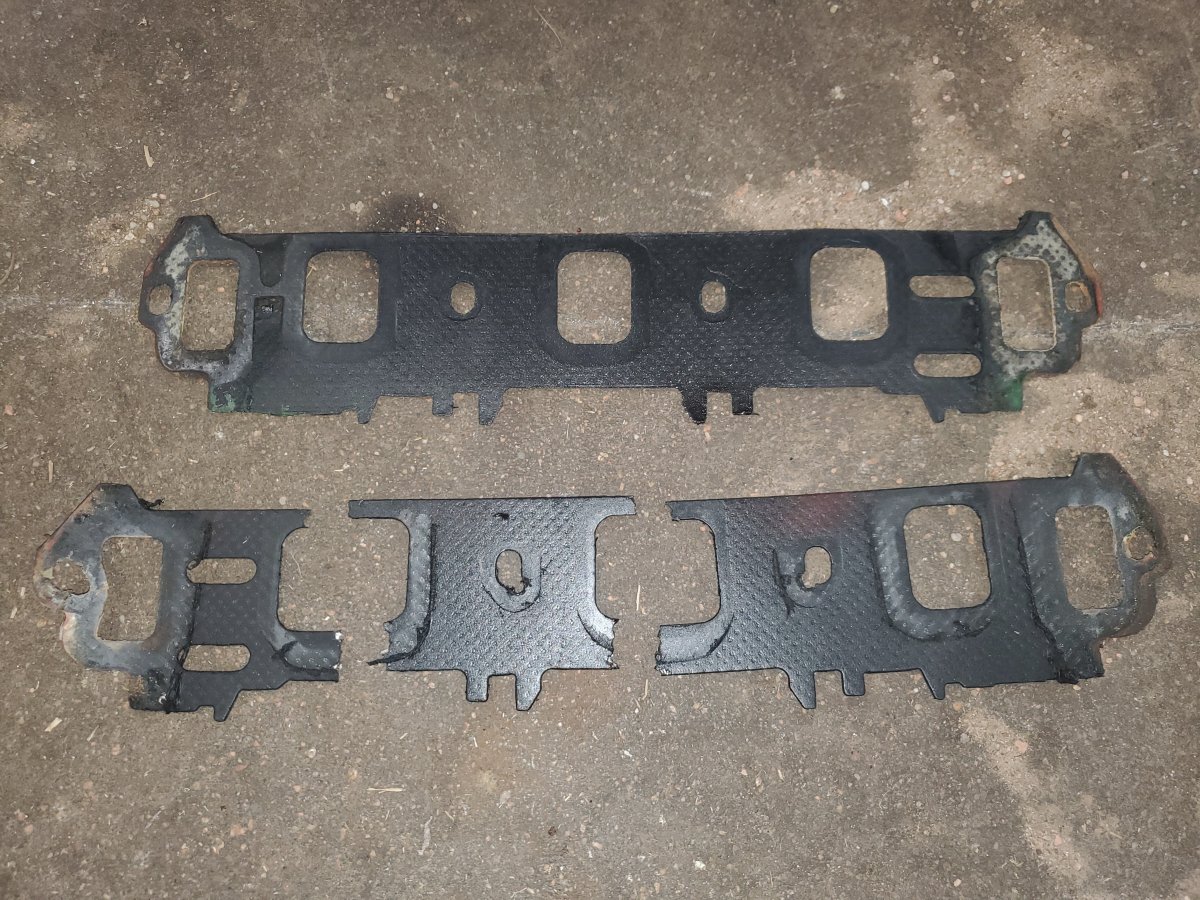

Hello I'm sorry I haven't responded to anyone on this for awhile but I have news on my ranger I found the problem on the reving I just finished it and now it runs fine my intake gasket was bad some how I don't know how this happened. I have included a picture
That'll do it. Big vacuum leak, right at the source, the intake manifold. Vacuum leaks usually cause an engine to idle high, due to too much air and leaned out mixture. Even back in the days of carburetors they were a hassle to find. At least back then, there weren't as many sources, fewer hoses, etc. Nowadays, engine compartments look like a bunch of spaghetti. I fondly remember my last real hotrod, a 1970 Pontiac Firebird Formula 400. Nothing under the hood but a motor, no ac, no condenser, nothing. Four barrel carb with a ram air hood, two snorkels on the air cleaner housing with rubber boots that sealed to the hood. Had to remove the air cleaner lid once a week to clean out bugs, leafs, etc. Much preferred to vehicles today. Wish I had never sold it.
