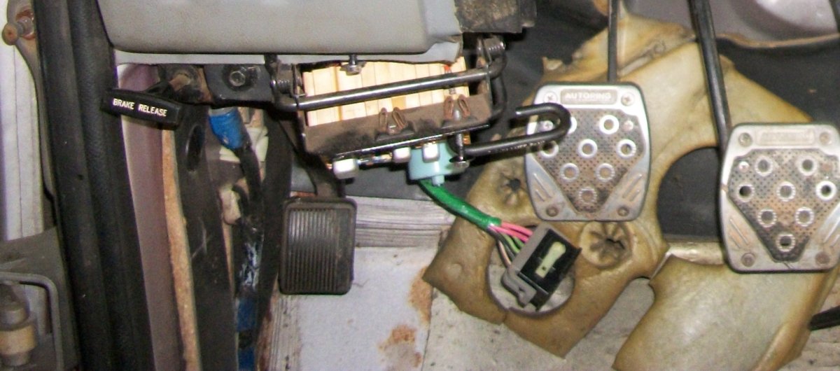

The truck already has the plug fastened to the big harness going through the firewall:
On my 1990 Bronco II the harness had green tape, and the jumper plug is the black block that it's plugged into. Just unplug the jumper, and plug the wiring harness connector into the triple function switch. A Ranger will be the same setup.

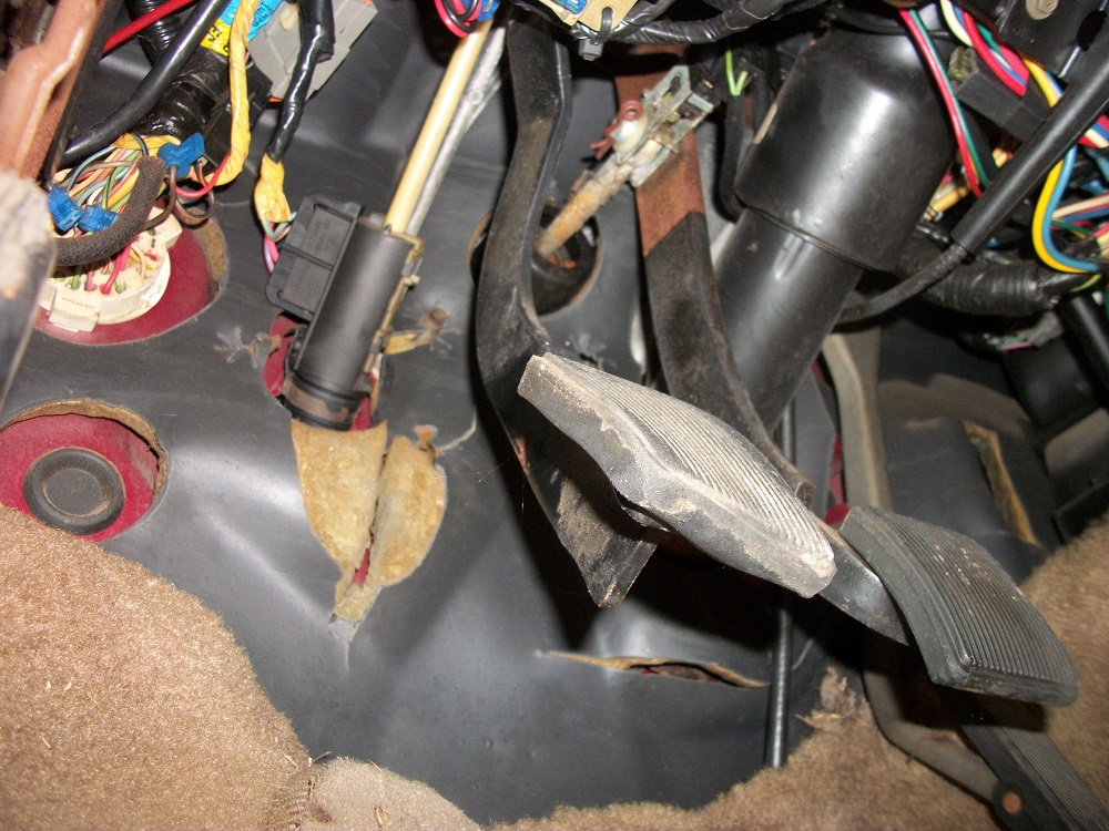

The triple function switch mounts like this (best view in another of my trucks; yours would be the same):
A metal clip mounts the switch to the clutch master cylinder end that sticks through the floor, which holds the switch, and the clutch pedal linkage rod slides inside of the switch, held in place with a plastic cover. The rod sliding through the switch opens and closes the contacts.
It's not difficult to set it up right, so why not?
