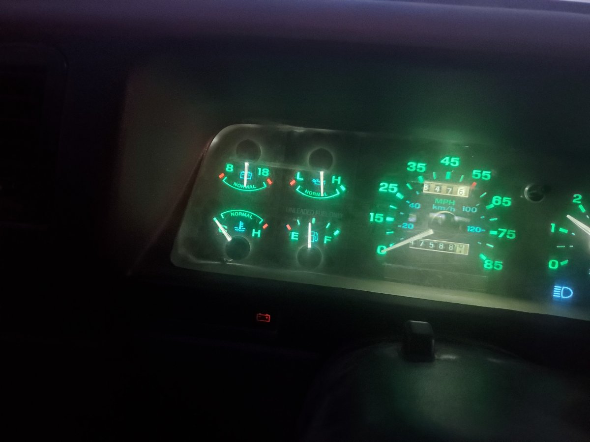

Thanks for the reply but no it really is an under cooling problem. I'll take a picture and add it my heater is actually pretty cold it heats up just a little enough to keep me from freezing lol. My thermostat is OEM and I did check for codes and I don't have any codes.

From what I see on your temp gauge (cold) and description of minimal heat from the heater... it would be better to say the engine won't reach operating temperature. That could also be considered over-cooling I guess but certainly not under-cooling.
How about you forget that term and tell us what is actually happening with the engine temperature. Does it run cold... doesn't heat up?
Right it's not heating up all the way. I felt my hoses and there warm but not like any of my other cars and I'm sorry if I was using the wrong term I'm still learning

I tested my tps sensor and it's good. I'll have to test the thermostat. I did put a peice of cardboard in front on my radiator and it did heat up more I was getting better heat out of my heater and my temperature gauge went up as well just above the cold line
