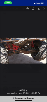

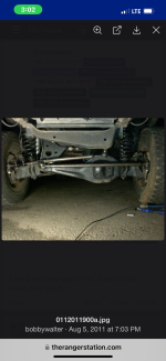

I can’t tell from your picture but that’s pretty much a stone crusher type? I found an old picture you posted in an old tread. That’s something to think about. I like the idea of that setup, it’s simple, way less work than a K link. Man I really appreciate it. It’s so hard to find info on this stuff.

I personally would not f around with a stonecrusher type link though. It somewhat solves the toeing-in issue you're having, but it still can have some pretty significant bumpsteer left-right that is more akin to having a bad draglink angle on a solid axle. I suspect it's also less-friendly to your tires than a K-Link (though still better than what you have now).
