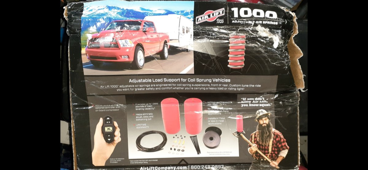

For about a hundred bucks you should be able to buy some helper air bags. I bought some for my other vehicle because it sat low as well. The work great and make it ride better.
For about a hundred bucks you should be able to buy some helper air bags. I bought some for my other vehicle because it sat low as well. The work great and make it ride better. View attachment 96578
Interesting, thanks for the suggestion! Are you still enjoying and happy with the airbag option?
