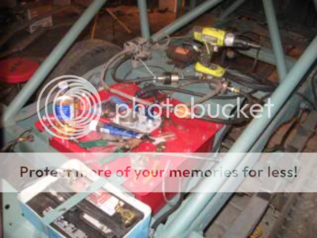

Not the greatest pic and I'm in the middle of the job;
From the blue anodized A/N fitting > fuel filter > low pressure pump > another filter > accumulator > High pressure pump - mounted on cross member > to another filter > to engine
The reason for all the filters was to enable me to use stock fuel line, I needed the filters as fuel line fitting adapters.
